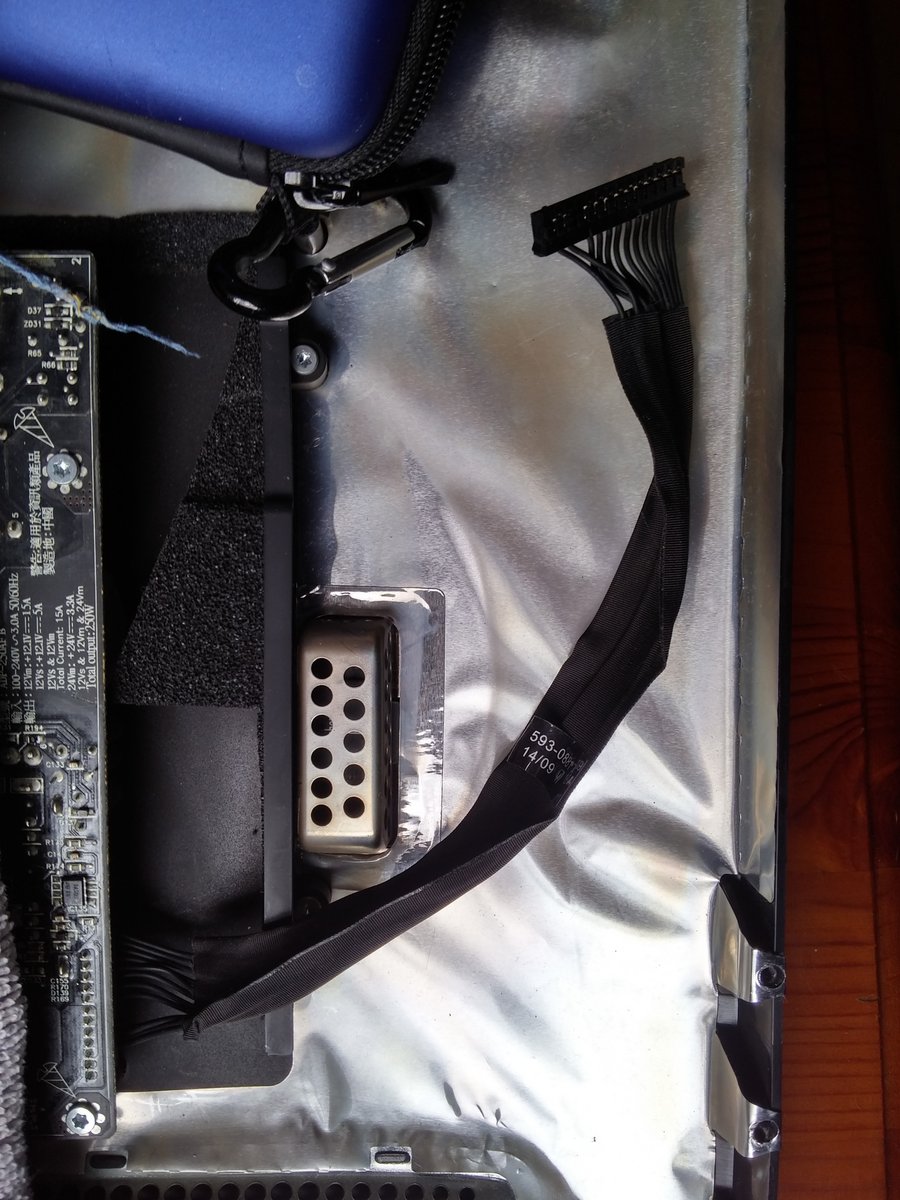

I have everything you need (or so I think) to use my imac lcd panel (panel LM240WU2 ( SL) ( B4 ) ) as a monitor for other pc
http://i62.tinypic.com/112e876.jpg
http://i61.tinypic.com/2mwxct2.jpg
also I connect the cable from the inverter to the lcd
this http://i59.tinypic.com/f10dts.jpg to http://i57.tinypic.com/f2itxd.jpg
Connect the power cord from the iMac ( white ) energy to the panel. and I connect the power adapter to the board vga 12V 2A
but does not work , connect via a PC to give vga video signal and does not work
do I wrong ?
Help please :(

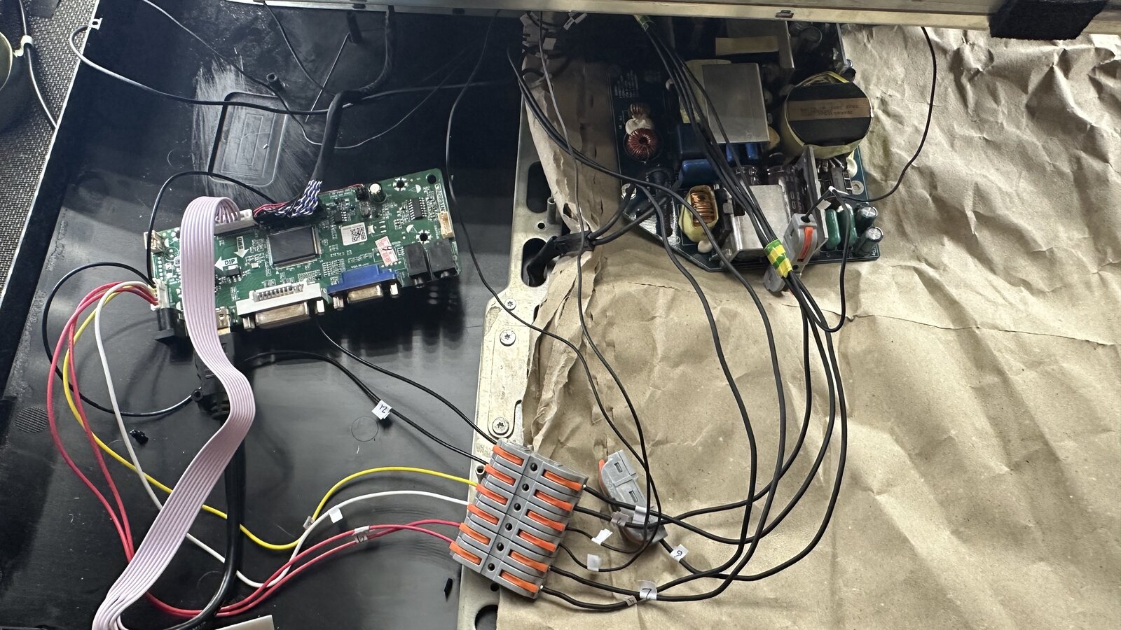

See https://pbase.com/brucemac/2019octdispla... for my successful conversion from a 24” iMac (Early 2009) to a monitor. The inverter board is built into this display, but you’ll need 24Vdc to drive it - Thus, you’ll need a power supply. (unless you can figure out how to make the original PSU work…)
Update (12/01/2020)
I’ve added a diagram of the boards & cable routing to the display:
https://pbase.com/image/171252938
Help that hopes!!

The original Apple Delta ADP-250AF B Power Supply can be used with the aftermarket video board.
To drive the backlight, all that is needed is the 24V from the original supply, and the gray & white wire from the aftermarket video board. The gray & white are properly wired in the connector for the backlight; the other end of the 24V connector (the 4 red/4 black) are not used, where the original cable from the PS to the backlight supplies the 24v. Pins 1-5 are 24V, 6-10 is GND, and 11 is P_DIM, 12 is BL_ON (Back Light ON). Thus, the gray & white can be spliced into the factory harness - White to 12 and Gray to 13. (See my pics on the link posted above for detailed pinouts)
When power is plugged into the Delta PS, 24V is always on, as is 12V on pin 5 of the large connector. Thus, the PS can drive both the video card and backlight. The original MB enables other pins such as the 12V on 9, 10, 11 on the large conn (3 to gnd), they are not needed.
I haven't tested this first hand, I expect it would work.
из
This post contains the pin-outs of the Delta PS, and what pins are shorted to enable the 3 12V pins on the large connector:
Power Supply pin (voltage, start other?))
I tested the outputs, and indeed, they work as outlined.

Hi,
You can use iMac's PSU to power LCD board controler (see here) but you have to add a bistable relay to enable imac's PSU (see here)
Schema
Bye,

Yes the bistable relay is useful to prevent electric shock
из
Do you use the original power supply without a fan? Is that ok?
из
I used the original power supply without fan.

you have to connect from LCD Displayboard controler, 2 wires BL_On and P_DIM to LCD power Connect (12 and 13 pins)

Hi,
You can use 27" iMac's PSU (LiteOn PA-2311-02A ADP-310AF) to power LCD video controler and inverter.
Был ли этот ответ полезен?
Счет 0
2 Комментариев:
Cool! Good information, and applicable to me! I use a 2017 iMac (Retina 5K, i5 Intel, Radeon Pro 575 4 Gb, 16Gb, 1Tb Fusion drive) as my daily driver, and also have an M2 MacBook air. I've often thought that when the iMac needs replaced, that I would convert it to a monitor and drive it with whatever Mac I have at the time.
Do you have part numbers/descriptions of the needed boards? I see the following:
LED Backlight board
Video Controller card
Keyboard (which probably comes with the VCC
Board with blue components (power relay?)
из
Yes, look at label at back of your LCD, you will find "THE special" video controller (included : LED Backlight board and Keyboard) on Amazon or Aliexpress for YOUR LCD (ex : for my 27" iMac's LCD -> LM270WQ1-SDA2).
The Board with blue components is used to enable PSU of IMAC to video controller (ex : Hailege 12V One-button bisstable self-locking relay module)
из
