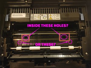

The first thing to look for on these is loose pieces that are just large enough to block the paper sensors; even dust can block them. I'm not as familiar with this engine as the older HPs and Lexmark engines, but if I had to take an educated guess, they're below the CDT sensors. See this photo for where the sensors are:
I would get some canned air and clean both of those, especially if the CDT sensors act like jam sensors and the primary sensors (likely below the CDT sensors, Color Tone Density Sensor). I'd also check the entire path, especially items like the fuser. Even a scrap can trip a sensor in weird places like that where nothing is visible.
If the issue remains, it could be that there's an issue with the sensors. This is a Xerox printer engine from 2015, so parts and SMs will not be easy to find. The Lexmark printers Dell rebranded are generally much easier to find parts for and determine where sensors are, as you can usually figure it out more readily, since Lexmark SMs are more readily available. Parts can be cross-swapped a lot more easily. For example, if someone has a Dell monochrome based on the Lexmark engine, it's based on the MS6 series as a start, if it has the 550-page tray, 250 is MS5. If it has a USB port, it will usually have a 550-page base configuration. That would be based on an MS6 engine. Based on that example, I know Dell's base printer is an MS610 or MS617. Dell stopped selling printers with the MSX21 series under that example, giving you a hard cutoff.

Thanks for the solution. I got it fixed by removing 2 crumbled up paper at the paper exist point, it was crumbled inside so I was not able to see them until I flash light it. Took me half an hour to pry them out though.
