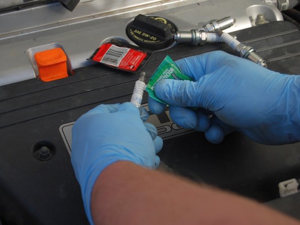

  7. 2003-2011 Honda Element Spark Plug Replacement: шаг 7, изображение 1 из 1
    • Remove new spark plugs from box. Apply anti-seize to the spark plug threads ONLY, carefully wipe off any excess that touches the ceramic insulator or the tip contact.
    • Now apply dielectric grease to the contact tip and the first 1/2" of the ceramic insulator.

  8. 2003-2011 Honda Element Spark Plug Replacement: шаг 8, изображение 1 из 1
    • Using the spark plug socket, put each spark plug into their hole and thread in hand tight.
    • Tighten all 4 plugs 1/2 turn past hand tight.

I torqued the spark plugs to 13 ft lbs.
