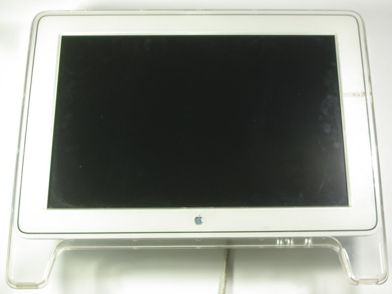

If the USB ports on the back of your display do not register connected devices or if they have no power, you may need to replace the USB port itself. This is a relatively easy fix. The tools required for this section are the spudger and the PH 2 screwdriver.

    1. Apple Cinema Display M8149 USB Port Replacement, USB Port: шаг 1, изображение 1 из 3 Apple Cinema Display M8149 USB Port Replacement, USB Port: шаг 1, изображение 2 из 3 Apple Cinema Display M8149 USB Port Replacement, USB Port: шаг 1, изображение 3 из 3
      • Before starting, make sure the display is UNPLUGGED. Failure to do so can result in shock and serious injury.
      • Flip the Cinema Display so it is on its face and the feet are pointed away from you.
      • Using the PH 2 screwdriver, unscrew the three feet screws (9.52 x 4.43 mm).
      • Remove the back foot from the hinge mount by gently pulling it upwards.
