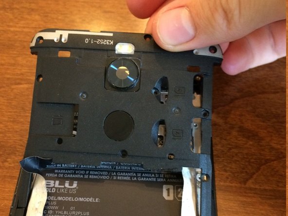

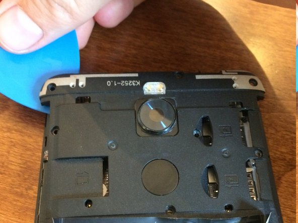

  5. BLU R2 Plus Rear-Facing Camera Replacement, Upper Plate Removal: шаг 5, изображение 1 из 3 BLU R2 Plus Rear-Facing Camera Replacement, Upper Plate Removal: шаг 5, изображение 2 из 3 BLU R2 Plus Rear-Facing Camera Replacement, Upper Plate Removal: шаг 5, изображение 3 из 3
    • Use an opening pick to unclip the upper plastic plate from the phone.
    • Once unclipped, slide it up and out of the phone.
    • Be careful not to break the small arms of the plate upon removal.

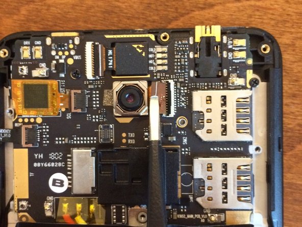

  6. BLU R2 Plus Rear-Facing Camera Replacement, Rear-Facing Camera Removal: шаг 6, изображение 1 из 3 BLU R2 Plus Rear-Facing Camera Replacement, Rear-Facing Camera Removal: шаг 6, изображение 2 из 3 BLU R2 Plus Rear-Facing Camera Replacement, Rear-Facing Camera Removal: шаг 6, изображение 3 из 3
    Инструмент, используемый на этом этапе:
    • Use a spudger to unclip the ribbon cable from the motherboard/logic board. Carefully use blunt tweezers or angled tweezers to pull the ribbon cable out of the socket. Then use the tweezers to wiggle the camera out of its socket.
    • Be very careful not to break the ribbon cable as it's very fragile. This doesn't really matter if you're taking the camera out as it's already broken.
