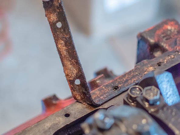

  5. Chevy 305 Engine Main Bearings Replacement: шаг 5, изображение 1 из 2 Chevy 305 Engine Main Bearings Replacement: шаг 5, изображение 2 из 2
    • Replace the oil pan gasket.
    • Use a razor blade, flathead screwdriver or putty knife to clean up the old gasket and wipe down where the old gasket was with brake cleaner and paper towels before placing a new gasket.
    • Be careful not to drop any gasket debris into the engine.
