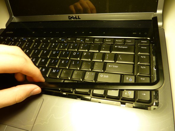

    3. Dell Studio 1535 Keyboard Replacement: шаг 3, изображение 1 из 3 Dell Studio 1535 Keyboard Replacement: шаг 3, изображение 2 из 3 Dell Studio 1535 Keyboard Replacement: шаг 3, изображение 3 из 3
      • Open the laptop
      • Take the flathead screwdriver, and put it under the bezel that goes around the keyboard
      • If you're simply fixing the existing keyboard, be careful not to pry a key off. They are close to impossible to get back on
      • Pry the bezel out of the frame. It might take some effort, but this is the correct method
      • Once one part has snapped out of the frame, continue to carefully remove the rest of the bezel

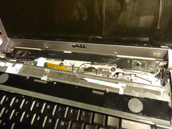

    4. Dell Studio 1535 Keyboard Replacement: шаг 4, изображение 1 из 3 Dell Studio 1535 Keyboard Replacement: шаг 4, изображение 2 из 3 Dell Studio 1535 Keyboard Replacement: шаг 4, изображение 3 из 3
      • Once the bezel is removed, put the screwdriver under the media control bar
      • Continue to apply pressure, prying it out of place; it should snap out easy
      • Do not rip it out without precaution. It's attached with a delicate ribbon cable, and if damaged, you'll be replacing more than the keyboard
      • Once snapped out of it's place, flip it over gently onto the keyboard

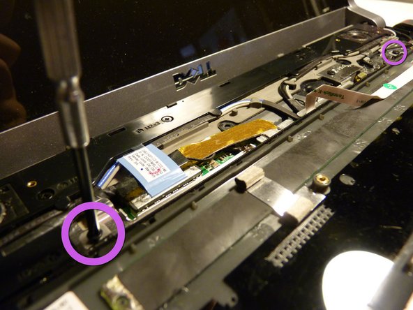

    5. Dell Studio 1535 Keyboard Replacement: шаг 5, изображение 1 из 2 Dell Studio 1535 Keyboard Replacement: шаг 5, изображение 2 из 2
      • Unscrew the two screws at the top of the keyboard using the Phillips screwdriver
      • Set the screws aside along with the other ones. They are the same size, no need to worry about getting them mixed up

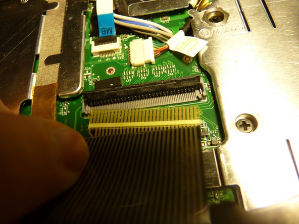

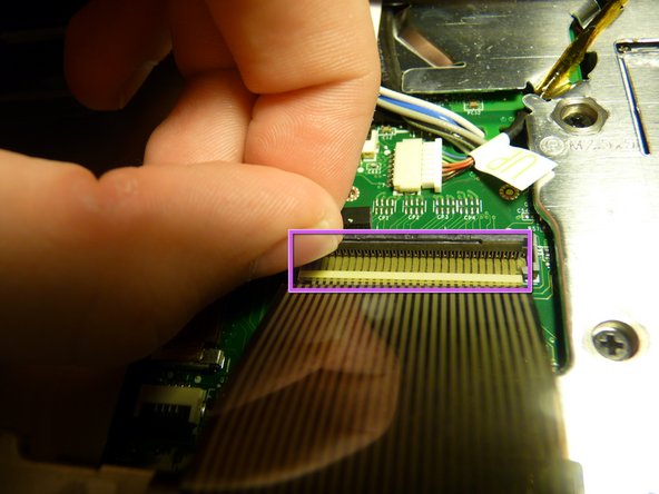

    7. Dell Studio 1535 Keyboard Replacement: шаг 7, изображение 1 из 3 Dell Studio 1535 Keyboard Replacement: шаг 7, изображение 2 из 3 Dell Studio 1535 Keyboard Replacement: шаг 7, изображение 3 из 3
      • Now that they physical keyboard is removed, we can focus on the ribbon cable
      • Caution, this step can make or break the connection point, so be gentle
      • Gently flip the black hatch part of the connection point upwards
      • Remove the ribbon cable from the connection point
      • When re-installing the cable, be sure that it is inserted all the way, and that the hatch is closed. If not, it may malfunction, or not work at all, and you will have to do this all over again
