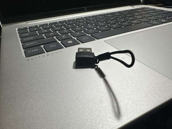

  2. Diagnosing and Erasing Hard Drives, Authors' Note:: шаг 2, изображение 1 из 2 Diagnosing and Erasing Hard Drives, Authors' Note:: шаг 2, изображение 2 из 2
    • You can buy these commercially if you do not have a broken Poly headset to pilfer one from, but they are typically only sold online. search for "USB-C to USB-A adapter" and look for one in this format.
    • This is the adapter that can be used to "make" USAP Type C USB adapters work on legacy PCs. I ripped this one off of a Poly headset at work that was being thrown out and kept it for this purpose:
