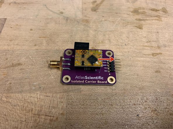

    • Locate the old style electrically isolated carrier board. If pins are soldered on, remove and solder on a 2 and 3 plug header or one 5-plug header.
    • Once the new attachments are soldered on, proceed to put the temperature circuit board into the connection holes. The black square of the circuit board should face towards the soldered attachments.
    • Cut wires to approximately 6 1/2 inches to allow enough length to secure the wires into the 5-plug header.
    • Refer to the temperature section of the wiring diagram when wiring the adapter.

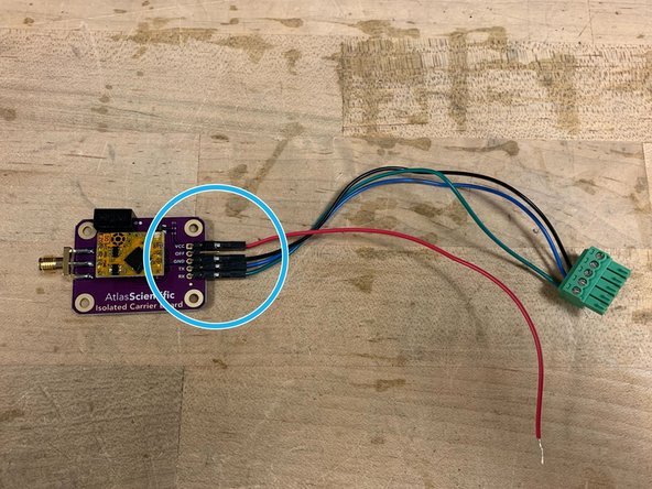

  3. Dissolved Oxygen Node Assembly, Dissolved Oxygen Board and Adapter: шаг 3, изображение 1 из 3 Dissolved Oxygen Node Assembly, Dissolved Oxygen Board and Adapter: шаг 3, изображение 2 из 3 Dissolved Oxygen Node Assembly, Dissolved Oxygen Board and Adapter: шаг 3, изображение 3 из 3
    • Locate the new style electrically isolated carrier board.
    • Locate the Dissolved Oxygen circuit board and place the board into the connection holes. The black square of the circuit board should face towards the pins.
    • Refer to the DO section of the wiring diagram when wiring the adapter.

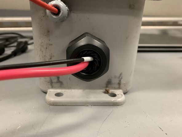

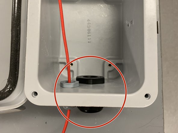

  4. Dissolved Oxygen Node Assembly, Cable Gland: шаг 4, изображение 1 из 2 Dissolved Oxygen Node Assembly, Cable Gland: шаг 4, изображение 2 из 2
    • Obtain the cable gland.
    • Screw the cable gland into the wall of the enclosure, through the large hole, as shown.

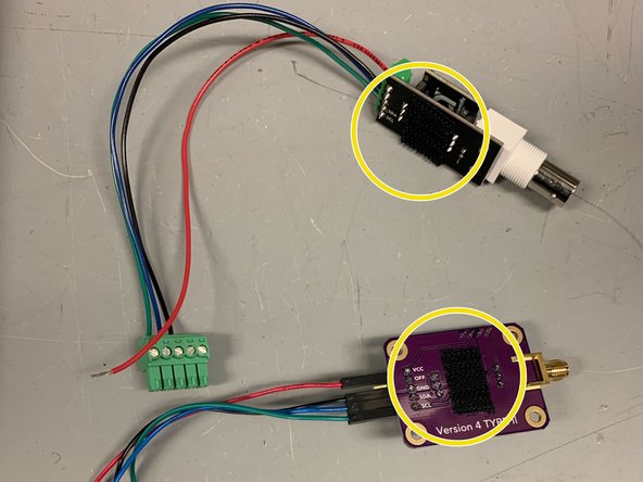

  5. Dissolved Oxygen Node Assembly, Velcro Attachments: шаг 5, изображение 1 из 2 Dissolved Oxygen Node Assembly, Velcro Attachments: шаг 5, изображение 2 из 2
    • Insert velcro strips with soft sides inside of the enclosure in the following places
    • Attach velcro with rough side onto the back of the adapters.

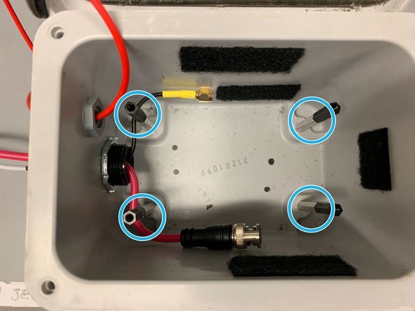

  6. Dissolved Oxygen Node Assembly, Wiring the sensors: шаг 6, изображение 1 из 3 Dissolved Oxygen Node Assembly, Wiring the sensors: шаг 6, изображение 2 из 3 Dissolved Oxygen Node Assembly, Wiring the sensors: шаг 6, изображение 3 из 3
    • Locate the Atlas DO sensor
    • Locate the Atlas PT-1000 Temperature Sensor

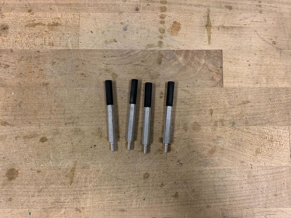

    • Obtain four 1.5-inch long standoffs and 4 1-inch long standoffs. Screw the standoffs together as shown, to make four 2.5-inch long standoffs
    • Thread the wires of the sensors into the cable gland. Proceed to screw the standoffs into the holes of the enclosure.

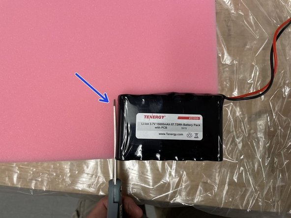

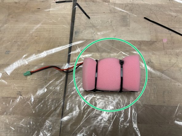

  7. Dissolved Oxygen Node Assembly, Battery: шаг 7, изображение 1 из 3 Dissolved Oxygen Node Assembly, Battery: шаг 7, изображение 2 из 3 Dissolved Oxygen Node Assembly, Battery: шаг 7, изображение 3 из 3
    • Obtain one battery, 4 zip ties, foam, and a pair of scissors
    • Cut out two battery-sized pieces of foam
    • Sandwich the battery between the two pieces of foam and secure it using the zip-ties. Connect the zip-ties to make two extra long zip-ties

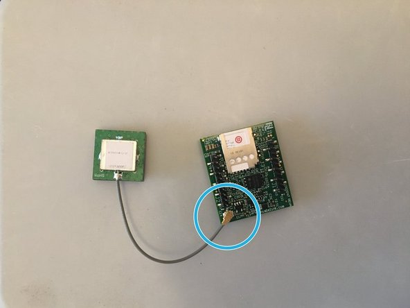

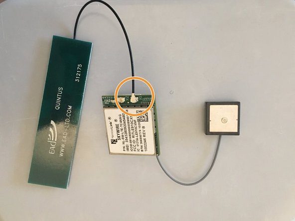

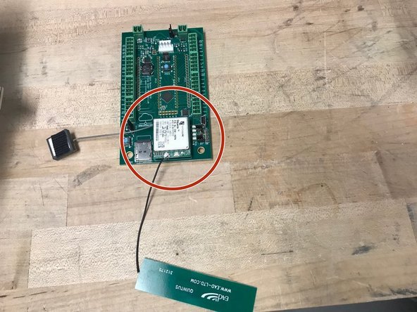

  8. Dissolved Oxygen Node Assembly, Attaching GPS and Antenna to Modem: шаг 8, изображение 1 из 3 Dissolved Oxygen Node Assembly, Attaching GPS and Antenna to Modem: шаг 8, изображение 2 из 3 Dissolved Oxygen Node Assembly, Attaching GPS and Antenna to Modem: шаг 8, изображение 3 из 3
    • Obtain the cell module (modem), GPS, and antenna
    • Insert Super SIM card into cell module
    • Attach the GPS to the connection shown (grey wire)
    • Attach the antenna to the connection shown (black wire)

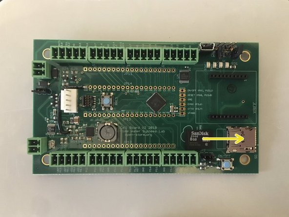

  10. Dissolved Oxygen Node Assembly, Board: шаг 10, изображение 1 из 3 Dissolved Oxygen Node Assembly, Board: шаг 10, изображение 2 из 3 Dissolved Oxygen Node Assembly, Board: шаг 10, изображение 3 из 3
    • Obtain Open-Storm board and place 4 jumpers in the spots shown
    • Insert microSD card into board
    • Attach the cellular module onto the sensor node board in the appropriate place

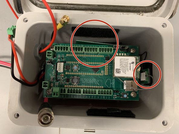

  11. Dissolved Oxygen Node Assembly, Assembling the Node Interior: шаг 11, изображение 1 из 3 Dissolved Oxygen Node Assembly, Assembling the Node Interior: шаг 11, изображение 2 из 3 Dissolved Oxygen Node Assembly, Assembling the Node Interior: шаг 11, изображение 3 из 3
    • Put the battery into the node enclosure between the area of the standoffs
    • Place the board with the modem and the GPS antenna onto the standoffs and GENTLY screw the board in place. Then stick the modem and GPS in the locations highlighted.
    • Stick the carrier boards onto the sides of the interior. Make sure to place the carrier in their respective location highlighted.
    • Follow the wiring diagram when wiring the carrier boards to the circuit board.

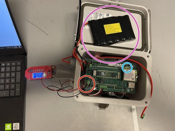

  12. Dissolved Oxygen Node Assembly, Adjusting Solar Charger Potentiometer: шаг 12, изображение 1 из 3 Dissolved Oxygen Node Assembly, Adjusting Solar Charger Potentiometer: шаг 12, изображение 2 из 3 Dissolved Oxygen Node Assembly, Adjusting Solar Charger Potentiometer: шаг 12, изображение 3 из 3
    • Obtain USB power supply, plug into a laptop, and set output to 5.9V
    • Check the voltage with a voltmeter (you may have to set the power supply to ~5.8V for the voltmeter to read 5.9V)
    • Plug in the green terminal block from the power supply into the Open-Storm board solar port.
    • Confirm the solar charge LED is off.
    • Plug in a dead battery to the battery port. This step will not work with a charged battery
    • CAREFULLY turn the silver potentiometer next to the charge controller IC with a small flathead screw driver until the charge light turns on.
    • Although the screw has a phillip screw head, using a phillip screwdriver may damage the potentiometer. The hole in the center is too shallow for most screwdrivers. It is easier to use a flathead screwdriver!

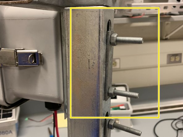

  15. Dissolved Oxygen Node Assembly, Node Handle: шаг 15, изображение 1 из 1

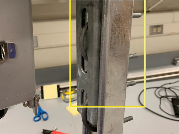

  16. Dissolved Oxygen Node Assembly, Node Structure: шаг 16, изображение 1 из 3 Dissolved Oxygen Node Assembly, Node Structure: шаг 16, изображение 2 из 3 Dissolved Oxygen Node Assembly, Node Structure: шаг 16, изображение 3 из 3
    • Locate a 5 foot long steel strut channel
    • Using U-bolts, attach the node handle to the strut channel as shown
  17. Dissolved Oxygen Node Assembly, Node Structure pt. 2: шаг 17, изображение 1 из 2 Dissolved Oxygen Node Assembly, Node Structure pt. 2: шаг 17, изображение 2 из 2
    • Using a zip tie, tie both of the sensor's cables together. Since the DO's cable is longer, make a loop to shorten its length
    • Using hose clamps, secure the cables and the sensors along the struct channel

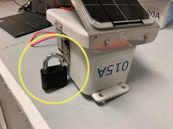

  18. Dissolved Oxygen Node Assembly, Preparing the Lock: шаг 18, изображение 1 из 1
  19. Dissolved Oxygen Node Assembly, Finishing Touches: шаг 19, изображение 1 из 3 Dissolved Oxygen Node Assembly, Finishing Touches: шаг 19, изображение 2 из 3 Dissolved Oxygen Node Assembly, Finishing Touches: шаг 19, изображение 3 из 3
    • The sensor lights in the node should be turned on
    • Attach the lock to the side of the node
    • Make sure to twist the cable gland so that the wires are snug together
