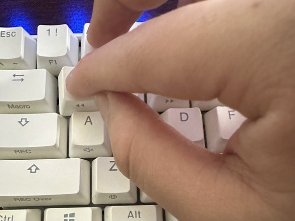

    • Use the switch puller to remove the keycap from the keyboard.
    • Remove all of the keycaps you need to replace or clean.

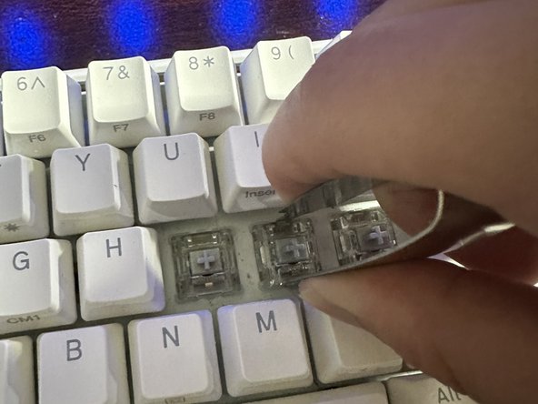

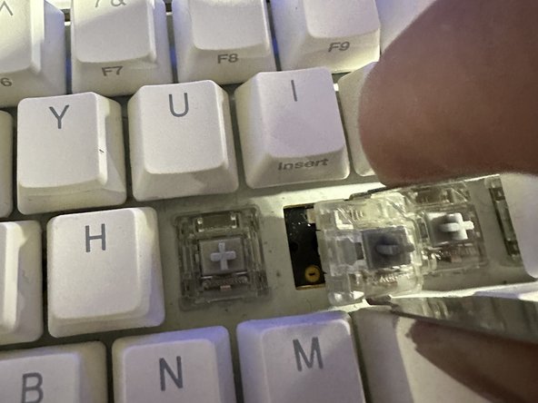

    • Use a key switch puller to secure the switch at the top and bottom.
    • Pull the switch away from the keyboard.
    • Ensure the switch puller is positioned and secured between the switch and the keyboard to prevent any damage to the switch.

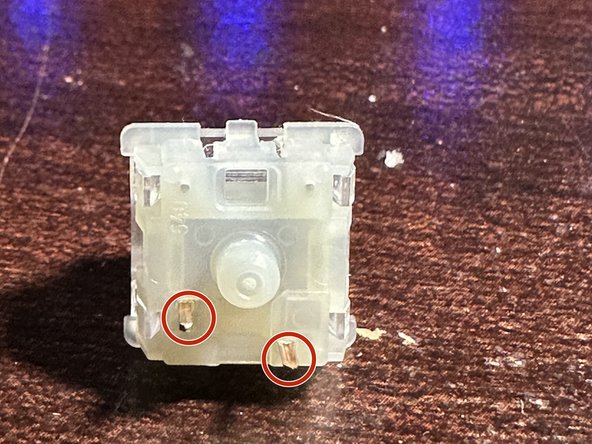

  5. Ducky One 3 SF Keycaps and Switches Replacement: шаг 5, изображение 1 из 1
    • Place all of the switches from the keyboard in a container.

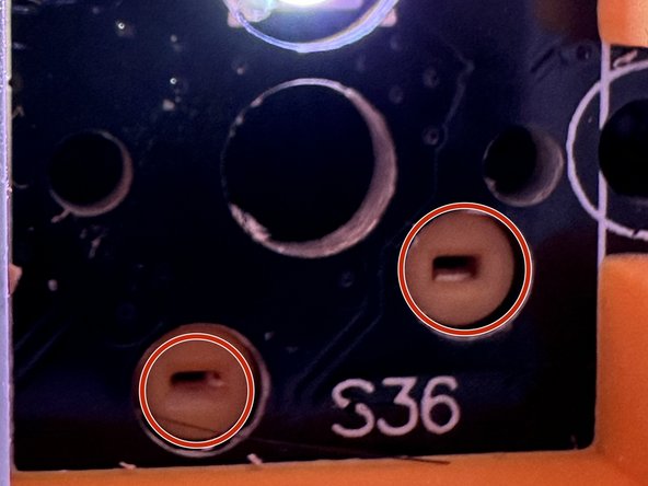

    • Insert the new switch into the corresponding holes in the keyboard and push the switch into position.
    • Make sure that the switch pins line up correctly with the holes on the keyboard so they don't get bent or damaged.

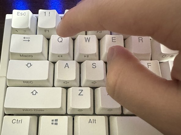

    • Replace each keycap in the correct position and press onto the key switch.
    • Use the following website to confirm both the correct positioning and functionality of the keycap.
