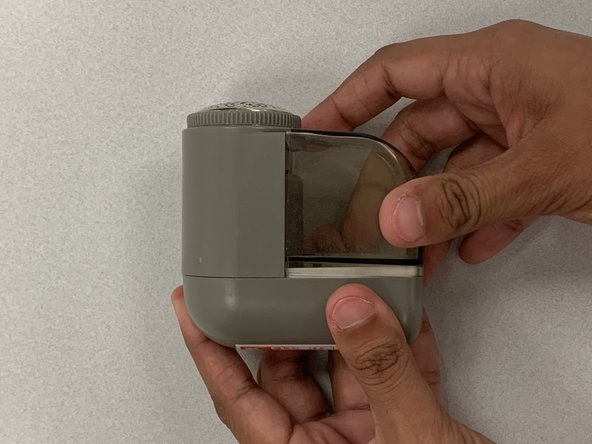

    • Remove the lint container by sliding to the right until it clicks off.
    • Remove any lint from the lint container for a clean process.
