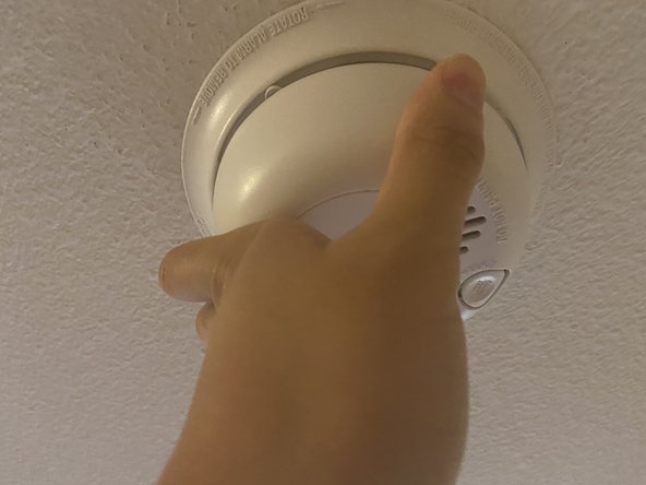

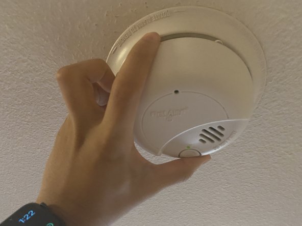

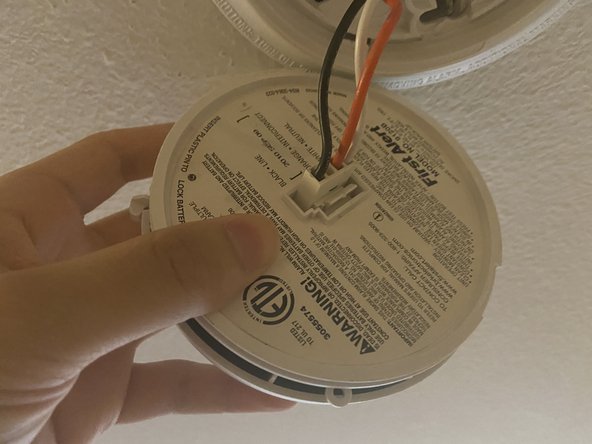

    • Remove the alarm by rotating it counter clockwise in the mount.
    • The alarm should fall off once rotated enough. The cable should be the only thing holding it in place if done correctly.

    • Unplug the cable from the alarm.
