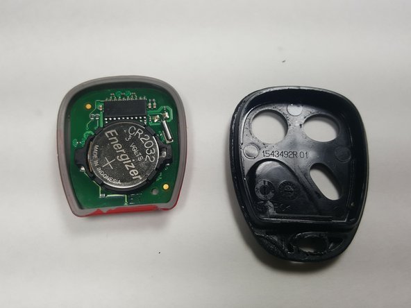

    • Remove the electrical board and rubber key pad from the old housing.

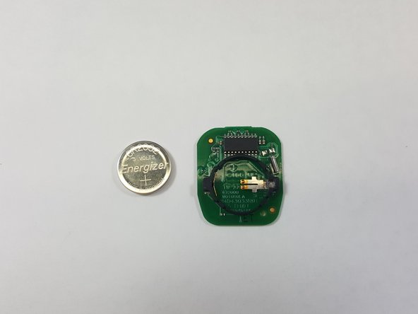

    • Remove the electrical board from the rubber key pad.
  5. GM Key Fob  Plastic Housing Replacement: шаг 5, изображение 1 из 2 GM Key Fob  Plastic Housing Replacement: шаг 5, изображение 2 из 2
    • If necessary, remove the battery from the electrical board and replace it.
