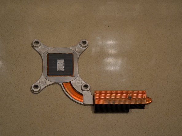

  31. HP Compaq nx7010 Business Notebook Teardown: шаг 31, изображение 1 из 3 HP Compaq nx7010 Business Notebook Teardown: шаг 31, изображение 2 из 3 HP Compaq nx7010 Business Notebook Teardown: шаг 31, изображение 3 из 3
    • Next out is the CPU heat-sink.
    • It is held in with 4 sprung screws place around each corner of the CPU
    • The thermal paste on the CPU can be a potential health hazard. Try not to come into contact with skin.
    • It is recommended (but not absolutely necessary) to re-apply thermal paste once the heat-sink has been removed to avoid overheating issues.
