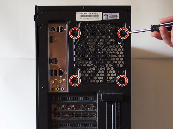

  5. How to Clean the iBuyPower i-Series R157LL001G Case Fan: шаг 5, изображение 1 из 3 How to Clean the iBuyPower i-Series R157LL001G Case Fan: шаг 5, изображение 2 из 3 How to Clean the iBuyPower i-Series R157LL001G Case Fan: шаг 5, изображение 3 из 3
    • Use a Phillips #2 screwdriver to remove the four 9.53 mm screws securing the fan to the computer case.
    • As you remove the final screw, gently hold the fan to ensure it does not fall. Lightly rest it against the component directly beneath it.
    • When screwing the fan back in, it can be mounted higher or lower depending on the opening in which you insert the screws. If you choose to reattach the fan at a different height, be sure that the screw locations are uniform.

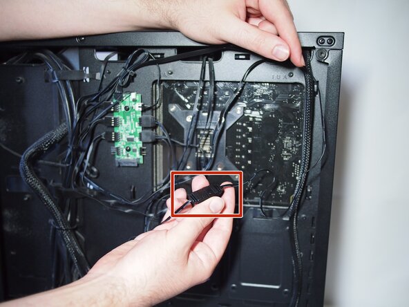

  7. How to Clean the iBuyPower i-Series R157LL001G Case Fan: шаг 7, изображение 1 из 3 How to Clean the iBuyPower i-Series R157LL001G Case Fan: шаг 7, изображение 2 из 3 How to Clean the iBuyPower i-Series R157LL001G Case Fan: шаг 7, изображение 3 из 3
    • Two cords extend from the fan to the now exposed back of the computer. Take the thicker fan cord (as shown in Photo 1) and follow it down until you reach the 3-pin connector (as shown in Photo 3).
    • Lightly jiggle the 3-pin connector as you slowly pull it out of the socket.
    • Do not pull the cables; it may damage the connector.
    • Let the connector hang loose.

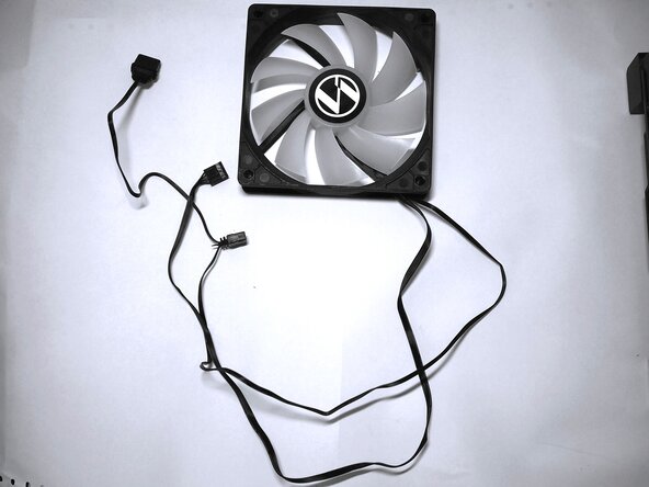

    • Remove the fan from the case and gently pull the cables out from the opening at the top
    • Lay the fan down on a flat surface, ensuring that the cords are not bunched up beneath it.
  10. How to Clean the iBuyPower i-Series R157LL001G Case Fan: шаг 10, изображение 1 из 2 How to Clean the iBuyPower i-Series R157LL001G Case Fan: шаг 10, изображение 2 из 2
    • With your soft-bristled brush, remove the dust from each fan blade on both the front and back.
    • While it isn't required, you may also lightly apply compressed air to remove more entrenched dust.
    • If you are using a can of compressed air that is nearly empty, propellant can spray out onto the fan blades. If this happens, lightly dry the fan with a microfiber cloth.
