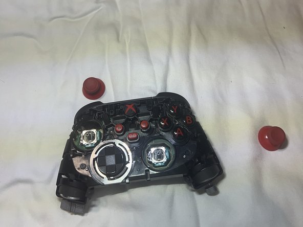

    • Use an opening tool to remove the back panels of the controller.
  2. How to Fix an Xbox One Controller Stuck Button: шаг 2, изображение 1 из 3 How to Fix an Xbox One Controller Stuck Button: шаг 2, изображение 2 из 3 How to Fix an Xbox One Controller Stuck Button: шаг 2, изображение 3 из 3
    • Remove the five screws from the back of the controller.
    • The 5th screw is behind the sticker in the battery compartment.

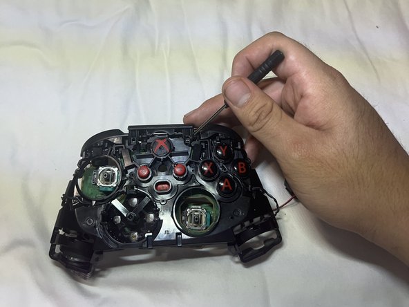

    • Remove the screws.
    • Flip the controller over and remove the joysticks.

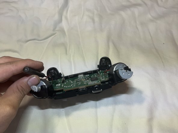

    • Remove both screws near the trigger.

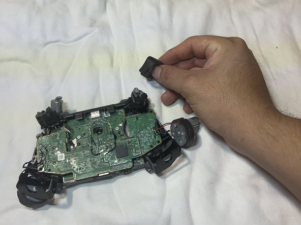

    • Remove the triggers to create more space.

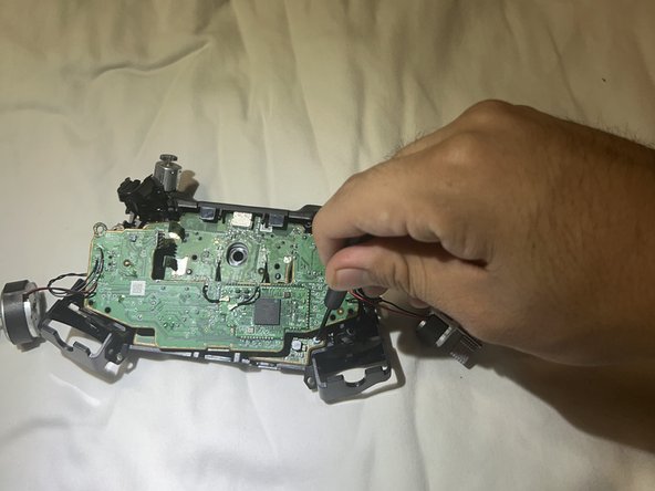

    • Remove the screws holding the motherboard.

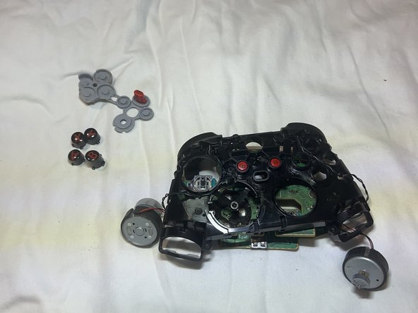

    • Remove the motherboard.
    • Remove the buttons.
