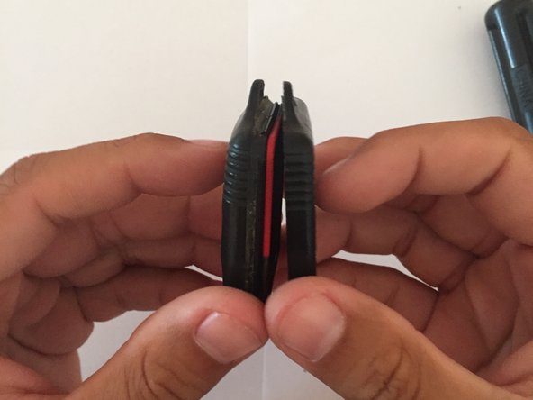

    • Locate the space to put the screwdriver.
    • Put the screwdriver in this space and pry open the remote.
    • You do not need to use much force to open it.

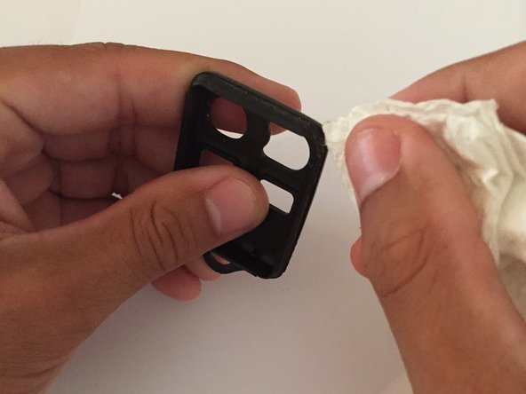

    • Clean out dirt from remote cover and button pad.
    • This helps the remote stick once you put it back together.

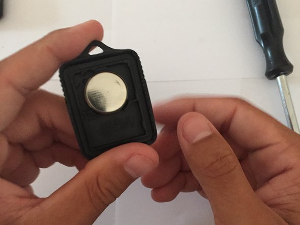

    • Put the screwdriver in between the battery and the remote cover.
    • Push the screwdriver down which will make the battery pop out of the remote cover.
  5. How to Replace Battery and Program Keyless Entry Remote for a Mercury Mountaineer  1997-2007: шаг 5, изображение 1 из 3 How to Replace Battery and Program Keyless Entry Remote for a Mercury Mountaineer  1997-2007: шаг 5, изображение 2 из 3 How to Replace Battery and Program Keyless Entry Remote for a Mercury Mountaineer  1997-2007: шаг 5, изображение 3 из 3

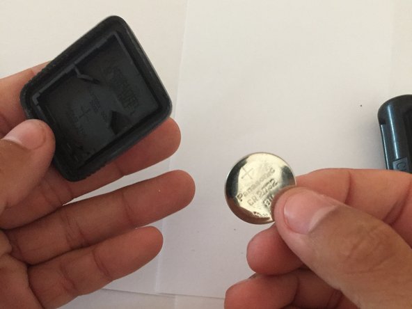

    • Get your new battery and locate the positive side.
    • Put the positive side facing down towards the cover.
    • Click it into its position.
    • Take the other half of the remote and put the case back together.

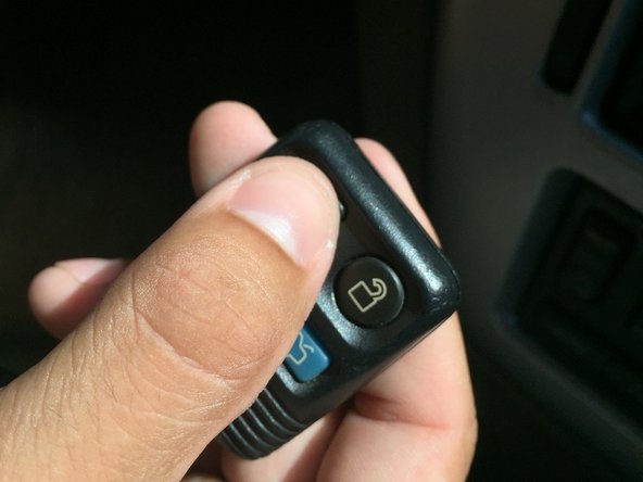

    • Turn off the car and take it out of the ignition.
    • Click all four buttons to check and see if the remote is paired.
Заключение
Once you can lock, unlock, open the trunk, and set off the car alarm. Your keyless entry remote has been paired.
