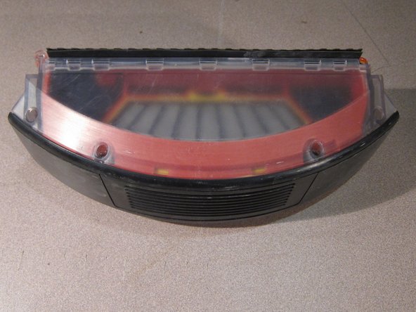

    • Remove dust bin from Roomba. This will be the first sub-assembly cleaned.
  2. How to disassemble and clean your Roomba 560: шаг 2, изображение 1 из 2 How to disassemble and clean your Roomba 560: шаг 2, изображение 2 из 2
    • Open red dust-bin cover. Remove debris from the dust-bin.
    • Remove the filter from the red dust-bin cover.
    • Remove the red dust-bin cover from the bin by gently pressing on the red cover near the hinge.

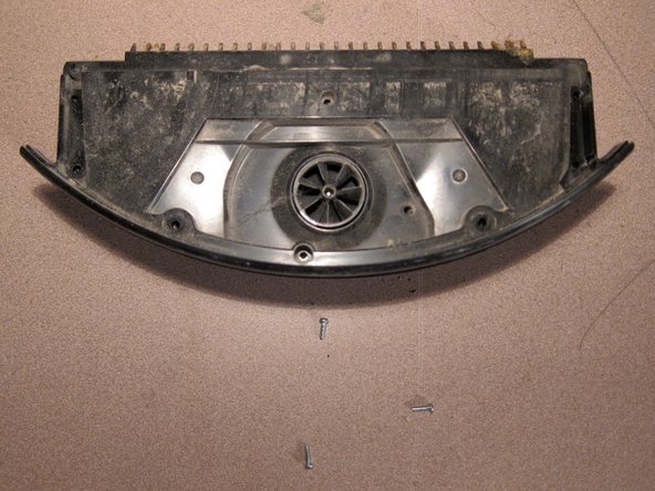

  8. How to disassemble and clean your Roomba 560: шаг 8, изображение 1 из 1
    • Clean all surfaces of the top plate of the dust bin.
  9. How to disassemble and clean your Roomba 560: шаг 9, изображение 1 из 1
    • Clean all sides of vent grill and between grill slats.

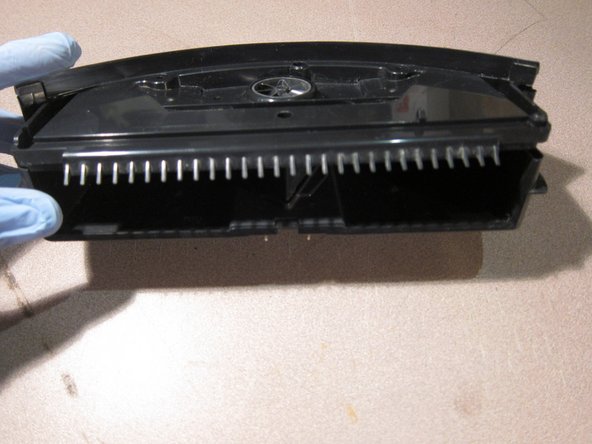

  10. How to disassemble and clean your Roomba 560: шаг 10, изображение 1 из 1
    • Clean all surface of the middle plate of the dust bin.
    • Clean between the teeth on the front edge of the plate.

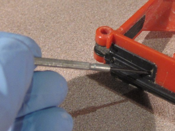

  13. How to disassemble and clean your Roomba 560: шаг 13, изображение 1 из 3 How to disassemble and clean your Roomba 560: шаг 13, изображение 2 из 3 How to disassemble and clean your Roomba 560: шаг 13, изображение 3 из 3
    • Clean all surfaces of the red dust-bin cover.
    • Use a small flathead screwdriver or pick to clean inside corners.
    • Replace filter with new filter for best results.

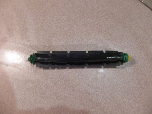

    • Open brush cage by pressing on yellow tabs and pulling up on the green brush cage lid.
    • Remove both brushes, lifting from the right side of the brushes.
  16. How to disassemble and clean your Roomba 560: шаг 16, изображение 1 из 3 How to disassemble and clean your Roomba 560: шаг 16, изображение 2 из 3 How to disassemble and clean your Roomba 560: шаг 16, изображение 3 из 3
    • Remove the two yellow endcaps from the bristle brush.
    • Run the brush through the red bristle cleaning tool, included with your Roomba.
    • Repeat several times until the the cleaning tool no longer picks up hair/fibers.

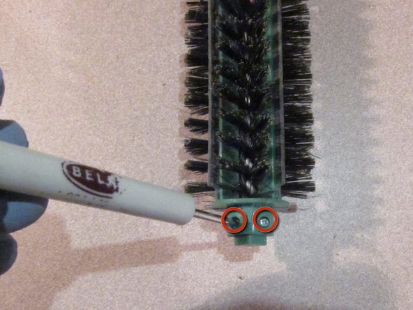

  17. How to disassemble and clean your Roomba 560: шаг 17, изображение 1 из 3 How to disassemble and clean your Roomba 560: шаг 17, изображение 2 из 3 How to disassemble and clean your Roomba 560: шаг 17, изображение 3 из 3
    • Clip the zip-tie with a pair of snips and remove the zip-tie from the brush.
    • Remove four screws from the ends of the brush.
    • Pull apart green brush housing.

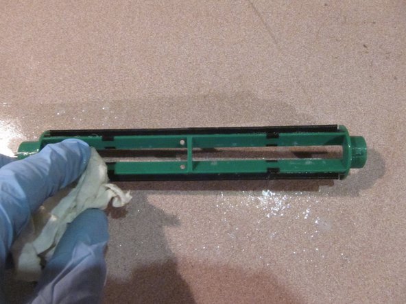

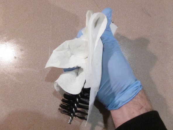

  18. How to disassemble and clean your Roomba 560: шаг 18, изображение 1 из 3 How to disassemble and clean your Roomba 560: шаг 18, изображение 2 из 3 How to disassemble and clean your Roomba 560: шаг 18, изображение 3 из 3
    • Spray bristles with an all-purpose cleaning solution.
    • Squeeze bristle rod with a paper towel and run bristle rod through paper towel.
    • Repeat several times until bristles are clean.

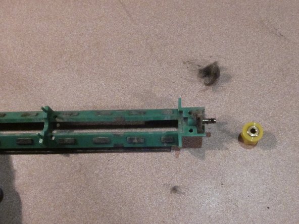

  19. How to disassemble and clean your Roomba 560: шаг 19, изображение 1 из 3 How to disassemble and clean your Roomba 560: шаг 19, изображение 2 из 3 How to disassemble and clean your Roomba 560: шаг 19, изображение 3 из 3
    • Remove yellow bearing from green bristle housing.
    • Clean yellow bearing and hair/fibers from the axle.
    • Clean all surfaces of both parts of the green bristle brush housing.

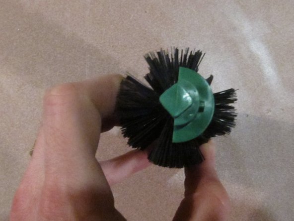

  20. How to disassemble and clean your Roomba 560: шаг 20, изображение 1 из 3 How to disassemble and clean your Roomba 560: шаг 20, изображение 2 из 3 How to disassemble and clean your Roomba 560: шаг 20, изображение 3 из 3
    • To re-assemble the green brush housing, push the green housing against the side of one row of bristles.
    • Push on the bristles until they no longer fan out and the bristle tips are lined up with the long slot in the green brush housing.
    • Rotate the green brush housing so the line of bristles goes through the slot in the green brush housing.
    • Repeat step for the other green brush housing.

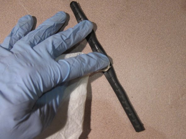

    • Remove plastic sweeper bar from brush housing.
    • Remove yellow plastic end-piece from axle.
    • Remove hair and debris from both ends of axle. You may need to use a small pick or manicuring scissors to remove hair from the axle.
  23. How to disassemble and clean your Roomba 560: шаг 23, изображение 1 из 2 How to disassemble and clean your Roomba 560: шаг 23, изображение 2 из 2
    • Spray all surfaces with cleaning solution. Wipe clean with paper towel. Follow up with smaller cleaning tools if necessary.

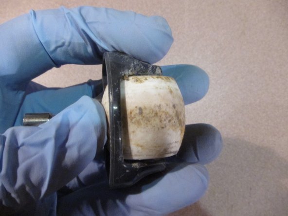

    • With Roomba wheels-up, grab onto front wheel and firmly pull straight up to remove wheel.
    • From the underside of the wheel housing, push the wheel out of the housing.
  25. How to disassemble and clean your Roomba 560: шаг 25, изображение 1 из 3 How to disassemble and clean your Roomba 560: шаг 25, изображение 2 из 3 How to disassemble and clean your Roomba 560: шаг 25, изображение 3 из 3
    • Remove the axle from the wheel.
    • Thoroughly clean the axle and the wheel with a paper towel and cleaning solution.
    • Thoroughly clean wheel housing with paper towel, cotton swab, and cleaning solution.
    • Re-assemble wheel housing by inserting axle in wheel and pressing wheel with axle back into wheel housing.
    • DO NOT insert wheel housing back into Roomba body. That will be done later.

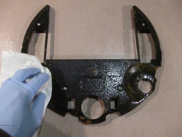

  28. How to disassemble and clean your Roomba 560: шаг 28, изображение 1 из 3 How to disassemble and clean your Roomba 560: шаг 28, изображение 2 из 3 How to disassemble and clean your Roomba 560: шаг 28, изображение 3 из 3

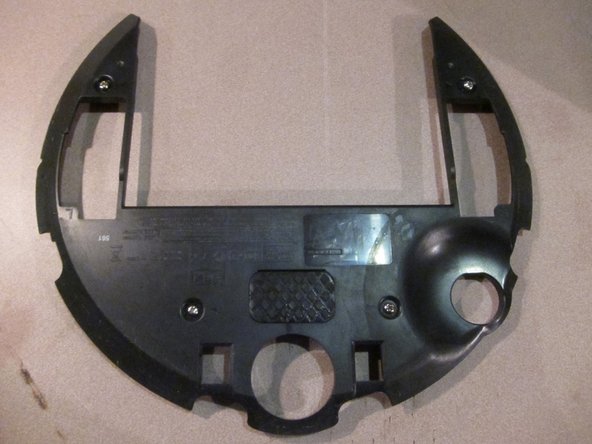

    • Unscrew 4 screws from the underside of the Roomba. Screws will separate from underside plastic plate.
    • Spray with cleaning solution and clean with paper towel. Follow up with smaller cleaning tools if needed.
    • Set aside for later installation.

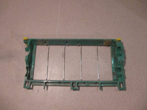

  30. How to disassemble and clean your Roomba 560: шаг 30, изображение 1 из 3 How to disassemble and clean your Roomba 560: шаг 30, изображение 2 из 3 How to disassemble and clean your Roomba 560: шаг 30, изображение 3 из 3

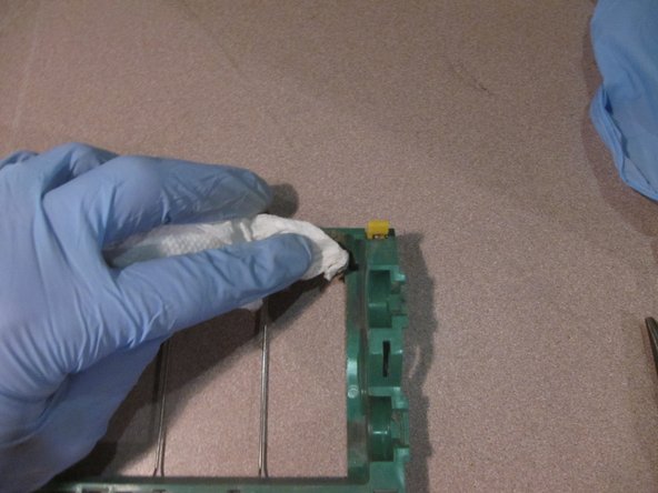

    • Place the brush assembly with the blue housing facing down.
    • Open the cage lid
    • Remove the brush cage lid by firmly pulling up at the hinges. Remove one hinge at a time.
    • Clean all surfaces of the brush cage with cleaning solution, paper towels, and cotton swabs. You may need to use a pick to clean tight corners and slots.

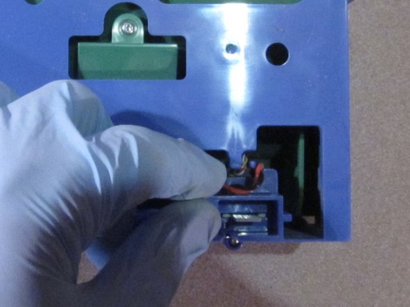

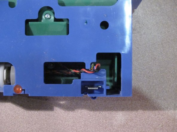

  31. How to disassemble and clean your Roomba 560: шаг 31, изображение 1 из 3 How to disassemble and clean your Roomba 560: шаг 31, изображение 2 из 3 How to disassemble and clean your Roomba 560: шаг 31, изображение 3 из 3
    • Place brush cage housing upside down (blue part up).
    • Remove screw securing daughtercard.
    • Move black and red wires inside the blue housing. This is required when separating the green brush cage assembly from the blue housing.
  32. How to disassemble and clean your Roomba 560: шаг 32, изображение 1 из 2 How to disassemble and clean your Roomba 560: шаг 32, изображение 2 из 2
    • Remove red sticker. This is holding down a small, round, weight attached to a cable.
    • Pull the cable through the channel. This cable limits travel of the blue housing.

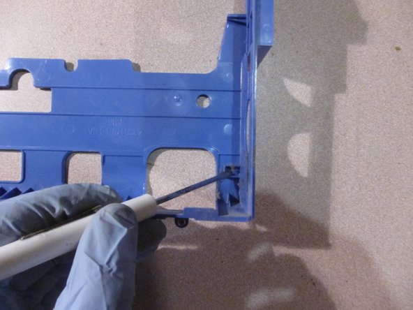

  34. How to disassemble and clean your Roomba 560: шаг 34, изображение 1 из 3 How to disassemble and clean your Roomba 560: шаг 34, изображение 2 из 3 How to disassemble and clean your Roomba 560: шаг 34, изображение 3 из 3
    • Clean all surfaces of the blue housing with cleaning solution, paper towels, and cotton swabs. Use a pick to clean the debris out of tight spaces.

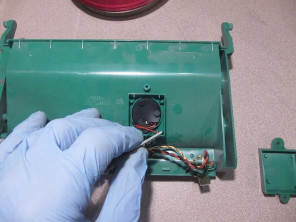

  35. How to disassemble and clean your Roomba 560: шаг 35, изображение 1 из 3 How to disassemble and clean your Roomba 560: шаг 35, изображение 2 из 3 How to disassemble and clean your Roomba 560: шаг 35, изображение 3 из 3
    • Place green brush cage upside down.
    • Remove 2 screws securing the square sensor cover. Set sensor cover aside.
    • Remove daughtercard from daughtercard mount.
  36. How to disassemble and clean your Roomba 560: шаг 36, изображение 1 из 2 How to disassemble and clean your Roomba 560: шаг 36, изображение 2 из 2
    • Flip the green brush cage over.
    • Remove the sensor by gently pressing on the silver disc.

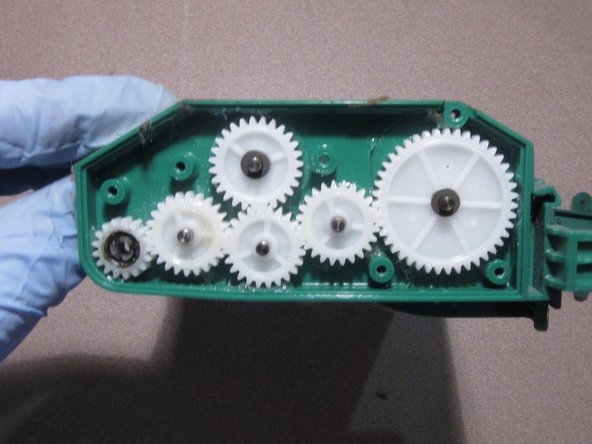

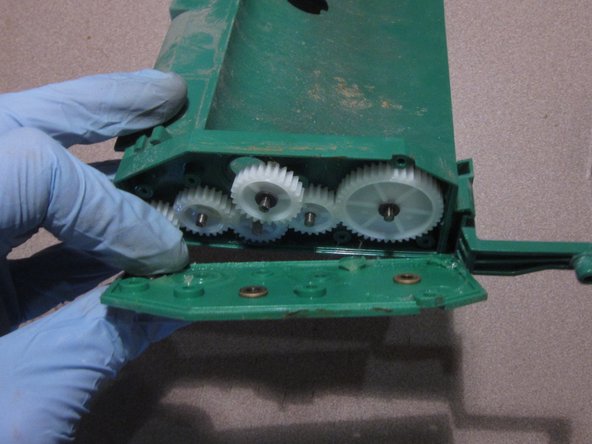

  38. How to disassemble and clean your Roomba 560: шаг 38, изображение 1 из 3 How to disassemble and clean your Roomba 560: шаг 38, изображение 2 из 3 How to disassemble and clean your Roomba 560: шаг 38, изображение 3 из 3
    • Remove 6 screws from the gear housing.
    • Pull front cover away from the brush cage body.

    • Clean all surfaces of the green housing with cleaning solution, paper towels, and cotton swabs. Use a pick to clean the debris out of tight spaces.

I've had my roomba at least 5 years and I've had to fix the bump sensor twice. There is an LED deep in the guts of your roomba that gradually dims, and when it goes you get roomba going in circles and beeping nine times. You can fix it but it requires some crazy disassembly and some soldering. See here for a guide: http://www.schneordesign.com/Avi/irobot/...
I have some extra LEDs from the last time I did this.
bobtins - Ответить
An alternative is to replace a surface-mount component on the main circuit board with a different value to accommodate the dimming LED in the sensor. This modification was posted in I think 2011 by a USA uni prof - I forget who. The left bump sensor relevant component to be replaced is R87, a 20k resistor (marked 203 in sm value coding). For the right bump sensor it is R82 again a 20k resistor of course. In each case the component to be removed and replaced is sited adjacent and parallel to a 1k resistor (sm marking 102), R86 and R83 respectively. He suggested using 130k resistors as replacement components, I used 220k to get a few more years out of my ageing Roomba 530. 1/8th watt conventional resistors fit reasonably well in place of the sm devices. It seems the section of the main circuit board containing the parts to be replaced is common to many of the model numbers, including component IDs and layout even when other parts of the board differ to the extent of including extra switches for some models.
