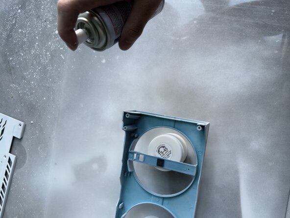

    • Remove all the accessories on your graphic card's casing(light strip, fans, fan cables)to prevent them from being damaged or covered up by the paint.
  2. How to repaint your graphic card, Preparation: шаг 3, изображение 1 из 1
    • Use fine sand paper(800-1000 grit) to first remove the original paint from your graphic card and prepare the surface. It's fine if you don't remove all the original paint, but make sure that the surface is smooth so the paint can stick on.

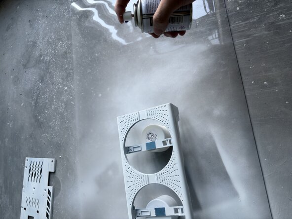

  3. How to repaint your graphic card, Painting: шаг 4, изображение 1 из 1

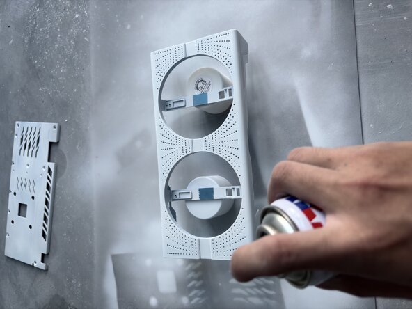

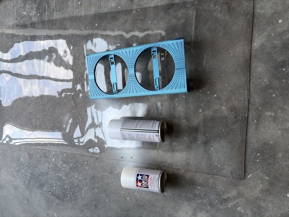

    • Find a well-ventilated area and put something underneath the casing to prevent getting paint on the ground. Put a box underneath the casing to make it easy to paint on the side of the card. Make sure you anchor the casing so that it doesn't wobble around.

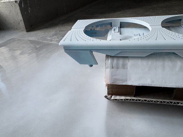

  4. How to repaint your graphic card, Applying the surface primer: шаг 5, изображение 1 из 1
    • Hold the nozzle down and spray a thin and even layer of surface primer paint onto the top of the graphic card, moving your arm horizontally. Avoid spraying continuously at one area and keep the can moving. Hold the can at a distance and paint only a thin layer every time.
    • Avoid applying a thick layer of paint, otherwise it might crack or bulge when drying.
    • Spray over the casing a few times until the surface primer had covered up the original color of the graphic card.

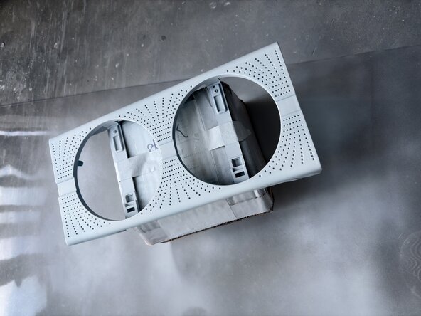

  5. How to repaint your graphic card, Applying the surface primer: шаг 6, изображение 1 из 1
    • Apply a layer of surface primer to the sides of the casing, using the same technique as before.
    • wait for the paint to fully dry, usually 20 minutes if you applied the paint correctly, and longer if you painted too thick.
    • It is important for the paint to dry before you proceed, so wait longer if you have to.

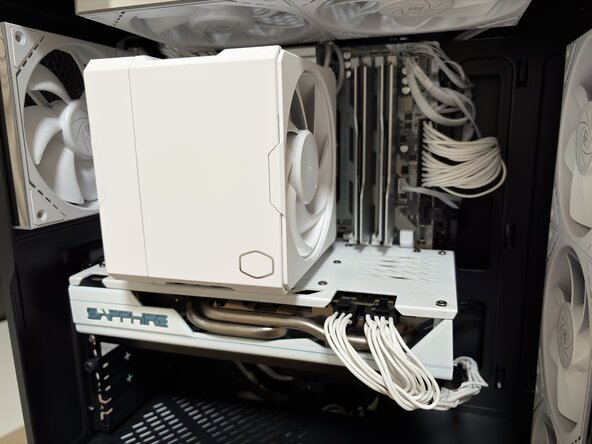

  9. How to repaint your graphic card: шаг 12, изображение 1 из 1
    • Wait 20 or more minutes for the paint to dry and reassemble your graphic card. Put it back into your computer and enjoy!
