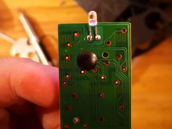

    • Open the wheel assembly
    • Desolder the led. The led is in the side with only one connection (red in the image)
  3. How to repair bObsweep wheel encoder, Replace: шаг 3, изображение 1 из 3 How to repair bObsweep wheel encoder, Replace: шаг 3, изображение 2 из 3 How to repair bObsweep wheel encoder, Replace: шаг 3, изображение 3 из 3
    • I am going to use a small led from a cheap remote
    • The positive led go to the side of the red wire
