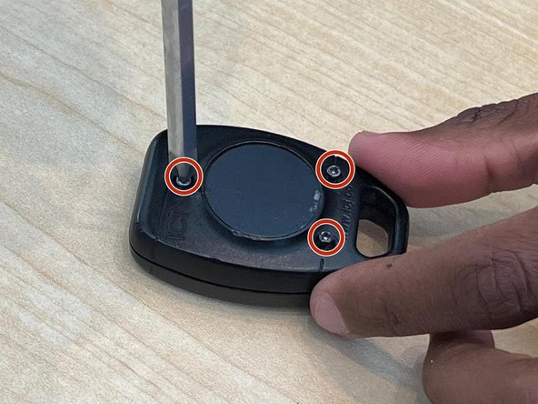

    2. ICT Key Fob Battery Replacement: шаг 2, изображение 1 из 2 ICT Key Fob Battery Replacement: шаг 2, изображение 2 из 2
      • Use the Phillips #00 screwdriver to remove three screws securing the battery compartment cover.
      • If there are no visible screws, the cover may be held in place by clips or a sliding mechanism.
      • Carefully open the compartment using a small tool if necessary.

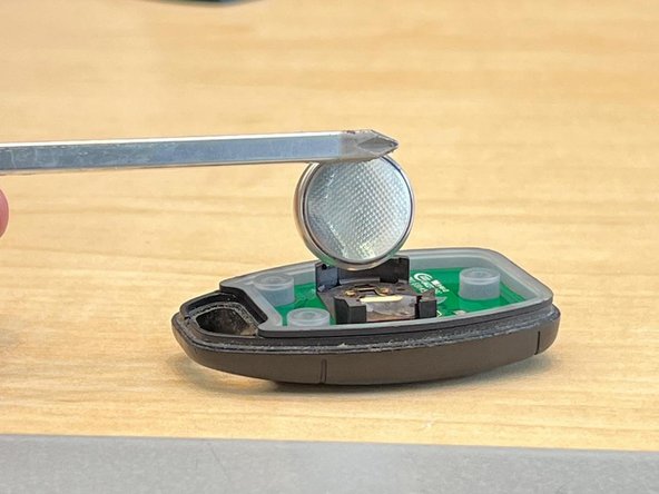

    4. ICT Key Fob Battery Replacement: шаг 4, изображение 1 из 2 ICT Key Fob Battery Replacement: шаг 4, изображение 2 из 2
      • Gently slide the battery out or lift it using an iFixit opening tool.

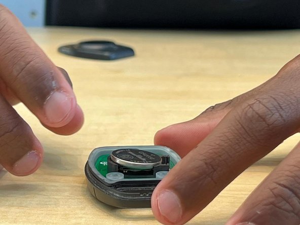

    6. ICT Key Fob Battery Replacement: шаг 6, изображение 1 из 1
      • Press the new battery firmly into place to ensure a secure connection.

Well, I'm not 89 but I still found this helpful. Wasn't sure how to pull the battery out without damaging the little clamp that was holding it in place so the tip to pry it out, gently pushing from under it, was very helpful. Thank you!
