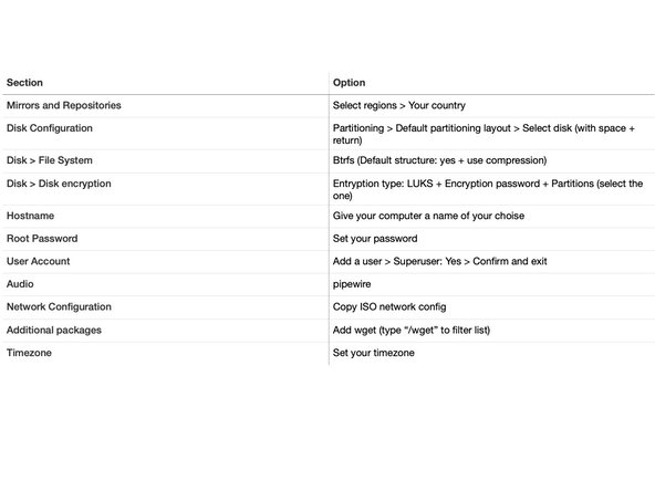

  1. Installing Omarchy on Arch, Installing Arch: шаг 7, изображение 1 из 1
    • Run the archinstall command and pick the options shown in the table to the left. Any options not mentioned should be left as-is.
    • You need to setup disk encryptuon to use Omarchy as designed. Omarchy reliese on the disk encryption to secure your device, and automatically logs you in after the disk has been decrypted at boot.
    • During the encryption setup process you won't be able to enter a password from a Bluetooth keyboard. You'll need keyboard that has a cable, or uses a 2.5ghz dongle.
