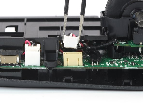

  10. Logitech G703 Battery Replacement, Disconnect the battery: шаг 10, изображение 1 из 3 Logitech G703 Battery Replacement, Disconnect the battery: шаг 10, изображение 2 из 3 Logitech G703 Battery Replacement, Disconnect the battery: шаг 10, изображение 3 из 3
    • Disconnecting the connector is tricky and may take a few tries. Don't grip the wires themselves, and try a different grip if you're having trouble.
    • Use a pair of tweezers to firmly grip the battery connector.
    • Hold the tweezers with your fingers as close to the connector as possible to get a firm grip.
    • Gently rock the connector side‑to‑side while pulling straight up to slide it out of the socket.
    • During reassembly, make sure the connector is properly oriented—it should slide into place easily.

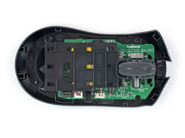

  11. Logitech G703 Battery Replacement, Unscrew the battery housing: шаг 11, изображение 1 из 2 Logitech G703 Battery Replacement, Unscrew the battery housing: шаг 11, изображение 2 из 2
    • Use a Phillips screwdriver to remove the two 3.4 mm‑long screws securing the battery housing to the bottom half of the mouse.
  12. Logitech G703 Battery Replacement, Remove the battery housing: шаг 12, изображение 1 из 2 Logitech G703 Battery Replacement, Remove the battery housing: шаг 12, изображение 2 из 2
    • Remove the battery housing.
