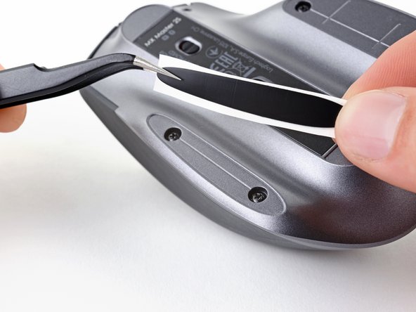

  2. Logitech MX Master 2S Mouse Feet Replacement, Separate the mouse foot adhesive: шаг 2, изображение 1 из 3 Logitech MX Master 2S Mouse Feet Replacement, Separate the mouse foot adhesive: шаг 2, изображение 2 из 3 Logitech MX Master 2S Mouse Feet Replacement, Separate the mouse foot adhesive: шаг 2, изображение 3 из 3
    • Insert an opening pick between the left foot and the lower case.
    • Go slowly, and make sure the pick slides underneath both the foot and its adhesive pad. These layers separate easily.
    • If you plan on reusing your mouse feet, be careful not to crease them or separate them from their adhesive pads.
    • Slide your pick under the foot to separate its adhesive until you can grab it with your fingers.
    • If the pick feels stuck, apply more heat before continuing.

  5. Logitech MX Master 2S Mouse Feet Replacement, Reassembly information: шаг 5, изображение 1 из 3 Logitech MX Master 2S Mouse Feet Replacement, Reassembly information: шаг 5, изображение 2 из 3 Logitech MX Master 2S Mouse Feet Replacement, Reassembly information: шаг 5, изображение 3 из 3
    • For installing new mouse feet or reusing your old ones:
    • Use a pair of tweezers or a spudger to remove any large chunks of leftover adhesive.
    • Thoroughly clean the bottom of the mouse with isopropyl alcohol and a lint-free of microfiber cloth. Allow the surface to dry completely.
    • Peel your new mouse feet away from their adhesive liners and press them firmly into place.
