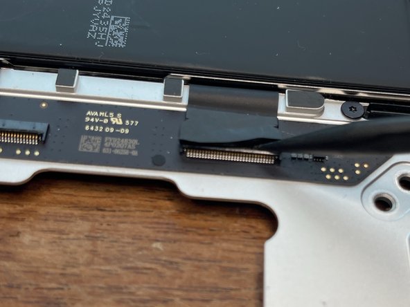

  3. Macbook Air 13" Retina Late 2020 Model A2337 Upper Body with Integrated Keyboard Replacement, Disconnect Trackpad: шаг 3, изображение 1 из 1
    • Disconnect the track pad cable from both the motherboard and the sisterboard. Two T3 screws hold a bracket and connection to mother board. At the sisterboard lift a locking clip and pull cable toward the battery, pulling on its black tape cover, to disengage it from the board

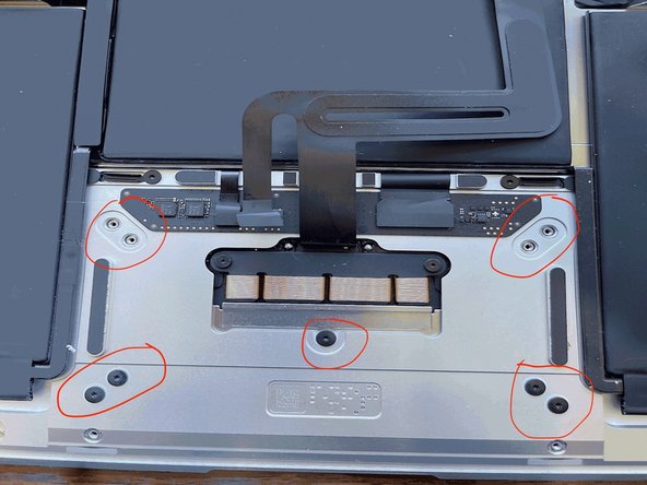

  4. Macbook Air 13" Retina Late 2020 Model A2337 Upper Body with Integrated Keyboard Replacement, Remove Trackpad: шаг 4, изображение 1 из 2 Macbook Air 13" Retina Late 2020 Model A2337 Upper Body with Integrated Keyboard Replacement, Remove Trackpad: шаг 4, изображение 2 из 2
    • Remove 9 black T5 screws holding track pad into the bottom case. 8 black screws in the corners and one in the middle. Then open the laptop to receive the trackpad into your hand and tuck the trackpad cable through hole in the bottom case.

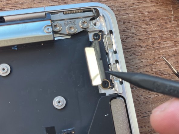

  6. Macbook Air 13" Retina Late 2020 Model A2337 Upper Body with Integrated Keyboard Replacement, Remove USB-C jack: шаг 6, изображение 1 из 2 Macbook Air 13" Retina Late 2020 Model A2337 Upper Body with Integrated Keyboard Replacement, Remove USB-C jack: шаг 6, изображение 2 из 2
    • Remove the USB-C jack's connection cable from the motherboard. Remove two T3 screws that are holding down silver and black bracket. Remove the bracket and use flat end of a spudger to lift the connector from the board.

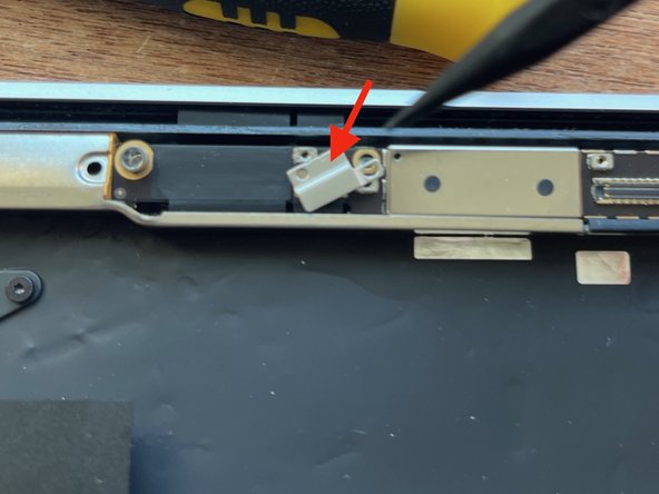

  7. Macbook Air 13" Retina Late 2020 Model A2337 Upper Body with Integrated Keyboard Replacement, Disconnect WiFi Radio: шаг 7, изображение 1 из 2 Macbook Air 13" Retina Late 2020 Model A2337 Upper Body with Integrated Keyboard Replacement, Disconnect WiFi Radio: шаг 7, изображение 2 из 2
    • Remove one T3 screw and lift the silver-colored Wifi connector hold down bracket. Using ESD safe tweezers, lift the two cables up from their sockets on the motherboard by the base of the connectors.
