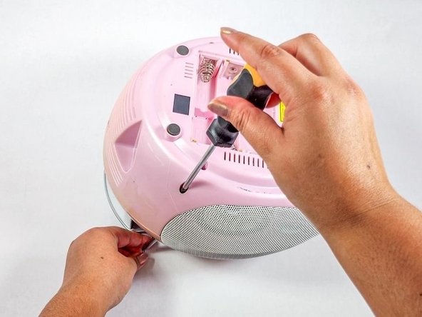

    • Flip radio upside down.
    • This radio is missing the lid for the battery compartment. If you have a battery cover, you must use a screwdriver to remove the screws before you can take off the cover.
    • Remove the batteries.

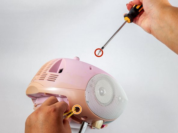

    • Flip radio so the back facing up.
    • The radio shown is missing the power cord. The power cord is a black cord attached to the back.
    • Unplug power cord.

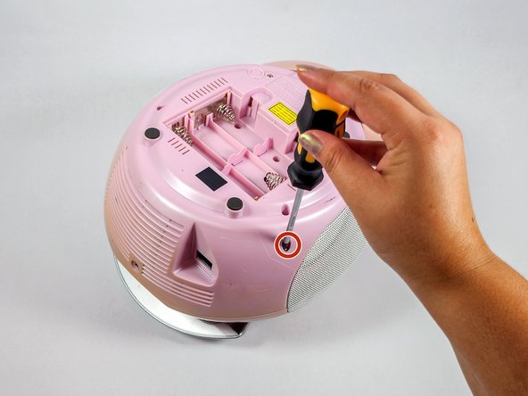

    • Flip the radio over so the bottom of the radio is facing up.
    • Insert the Philips #2 screwdriver into the antenna screw hole.

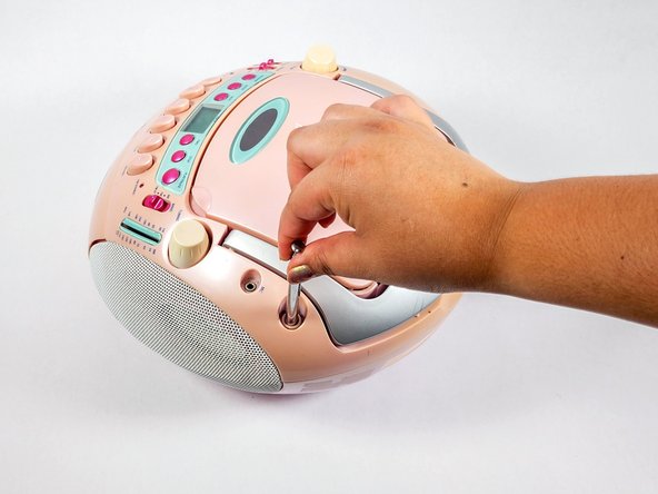

    • Use a Phillips #2 screwdriver to remove the screw securing the antenna.
    • Remove the antenna.
    • Use tweezers/pliers if your antenna is broken off or too short to hold.

    • Insert the new antenna into the antenna hole on top of the device.
  6. Mattel Barbie Boombox BE-466 Antenna Replacement: шаг 6, изображение 1 из 3 Mattel Barbie Boombox BE-466 Antenna Replacement: шаг 6, изображение 2 из 3 Mattel Barbie Boombox BE-466 Antenna Replacement: шаг 6, изображение 3 из 3
    • The new antenna is slightly bigger than the original. Use a 2.5mm x 8mm Phillips screw instead of the original screw.
    • Hold the antenna and insert the screw into the antenna screw hole.
    • Use the Phillips #2 screwdriver to secure the screw.
Заключение
To reassemble your device, follow steps 1 and 2 in reverse order.
