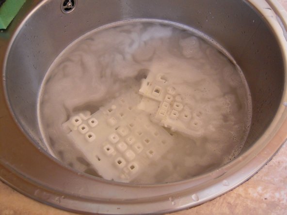

  6. Microsoft Natural Multimedia Keyboard disassembly and cleaning: шаг 6, изображение 1 из 3 Microsoft Natural Multimedia Keyboard disassembly and cleaning: шаг 6, изображение 2 из 3 Microsoft Natural Multimedia Keyboard disassembly and cleaning: шаг 6, изображение 3 из 3
    • Remove the flexible keypad from the key caddy assembly.
    • The key caddies can be washed in the sink.
  7. Microsoft Natural Multimedia Keyboard disassembly and cleaning: шаг 7, изображение 1 из 1
    • The keys can also be washed.
    • Remove the metal retaining clips before washing to prevent rust.

I’ve had this keyboard since it was released and it just recently started having key sticking issues, so I opted to follow this guide and was pleasantly surprised at how well it worked. Thank you for this and I hope to get another 15 years out of it.
Suggestions:
1) Instead of manually cleaning, put the keys into a clear mesh bag and into the dish washer or washing machine.
2) Spray metal retainer bars with WD-40 and wipe off to help further prevent rust.
3) Let the keys and caddies sun dry for the day to ensure they do not retain any water after cleaning.
