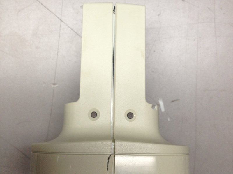

    1. Microsoft XBOX 360 Quick Charge Kit Bad Capacitor Replacement, Bad Capacitor causing charge to fail: шаг 1, изображение 1 из 2 Microsoft XBOX 360 Quick Charge Kit Bad Capacitor Replacement, Bad Capacitor causing charge to fail: шаг 1, изображение 2 из 2
      • Unit is glued together, making disassembly somewhat difficult. Using a utility knife, repeatedly score the plastic, top to bottom and all the way around, in the seam on the face, rear and bottom of the charger. The knife will begin to penetrate the charger.
      Спросите у FixBot
      Добавить комментарий
    2. Microsoft XBOX 360 Quick Charge Kit Bad Capacitor Replacement: шаг 2, изображение 1 из 1
      • Using a spudger or similar stiff plastic tool, begin prying around the unit in the line that you previously scored, avoid having the tool go in to the device and damaging components. Eventually it will split apart.

I just completed disassembly. It isn't necessary to cut into the seam. Instead, use the blade of a putty knife as a lever. Insert the putty knife into the seam/groove, and gently pry the two halves away from each other. You'll hear the glue start to crack with little or no damage to the plastic. Repeat all the way around. It may be necessary to use a second putty knife, or a thicker similar tool, as the gap begins to widen. Just keep prying in this way until the two peices are free. Don't use a screwdriver... It will just ding the plastic. Also be sure to cut the label on the bottom first (a razor blade or exacto knife makes a nice clean cut).
