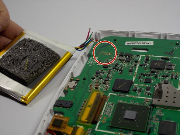

  6. Nabi Jr Battery Replacement: шаг 6, изображение 1 из 1
    • Remove the battery from the motherboard
    • De-solder the colored wires
    • Be sure to note the order in which the wires are connected to the board before desoldering them.
    • Be careful while removing the solder off of the colored battery wires. The soldering iron will be extremely hot

    • Replace the old battery with the new one
    • Solder the wires of the new battery into the pads on the motherboard
    • Be careful when soldering the wires in. Soldering iron will be extremely hot

My old Nabi jr battery is a plug in with 2 reds 1 white and 2 black wires. My new Cameron sino battery is blue green red yellow black. What is the order to resolder them.
Dennis Blixt - Ответить
I have the same problem with the problem of the replacement battery not having the same wiring configuration or plug. Did you ever get this resolved?
Delores Duke -
