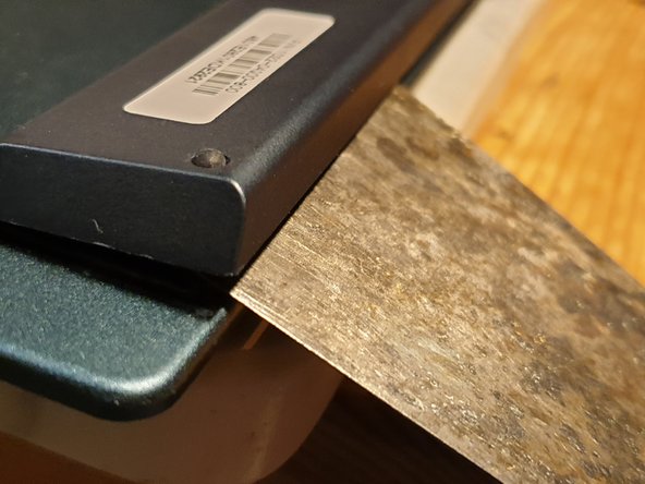

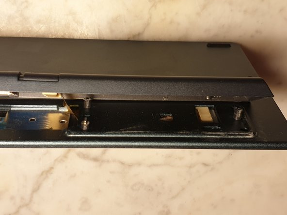

  2. Rapoo E6700 Keyboard  Connector Port Repair, Wedges and Spatulas: шаг 2, изображение 1 из 2 Rapoo E6700 Keyboard  Connector Port Repair, Wedges and Spatulas: шаг 2, изображение 2 из 2
    • Since the keayboard side is superglued (who needs sustainability when you can just buy a new one, duh) it is impossible to access the electronics from the topside.
    • The PCB and Battery compartment on the backside is screwed from the inside which makes it virtually impossible to teardown.
    • However, the screws are, well.. screwed into thin little poles which can easily be broken with enough (not too much) leverage.
    • Begin with prying one corner with the thin prying tool.
    • Then slide a more sturdy wedge or in this case spatula underneath the first tool

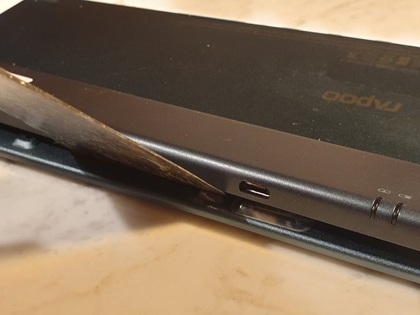

  3. Rapoo E6700 Keyboard  Connector Port Repair, wiggle wiggle wiggle: шаг 3, изображение 1 из 3 Rapoo E6700 Keyboard  Connector Port Repair, wiggle wiggle wiggle: шаг 3, изображение 2 из 3 Rapoo E6700 Keyboard  Connector Port Repair, wiggle wiggle wiggle: шаг 3, изображение 3 из 3
    • Now lay down the keyboard somewhere raised and press on the metal part so it wont bend.
    • Then youll need to wiggle in the spatula or tool of choice with an angle since the screwplate has a raised border.
    • Then slowly apply force to SLOWLY wedge the plastic plate upwards.

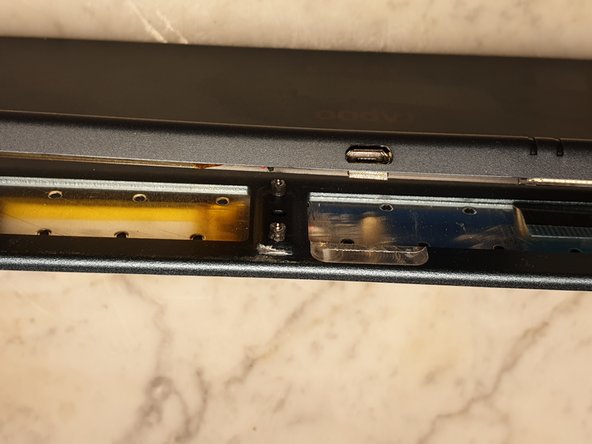

  4. Rapoo E6700 Keyboard  Connector Port Repair, Screw placement: шаг 4, изображение 1 из 3 Rapoo E6700 Keyboard  Connector Port Repair, Screw placement: шаг 4, изображение 2 из 3 Rapoo E6700 Keyboard  Connector Port Repair, Screw placement: шаг 4, изображение 3 из 3
    • This particular Keyboard has four screws. One at each end and two in the middle.
    • Try to pop the screws at the ends first. Then the last two in the middle. Youll need to pry from each side.

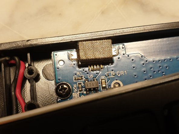

  7. Rapoo E6700 Keyboard  Connector Port Repair, The USB Port: шаг 7, изображение 1 из 2 Rapoo E6700 Keyboard  Connector Port Repair, The USB Port: шаг 7, изображение 2 из 2
    • Carefully rotate the keyboard ever so slightly to get access to the faulty USB Port.
    • And there we have it, that pesky little bugger. Now resolder and reassemble and you're good to go.
    • This bigger keyboard has two hooks at the inside of the plastic compartment so you can just snap it back in place.
    • With keyboards that don't have such hooks you might need to tape or superglue the parts back together.
    • Congratulations, you have (hopefully) successfully repaired the USB Port.
