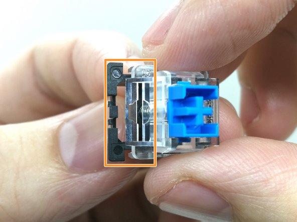

    • Using a Kailh-style switch opener (which has two wide prongs instead of four), position the switch on top so that the two plastic tabs on the side of the switch are positioned on top of the two prongs underneath.
    • Press very firmly downwards until both tabs unlock.
    • If one tab unlocks and the other tab does not, reset both sides and try again.
    • Alternatively, wedge a spudger underneath the first tab and unlock it slightly.
    • Wedge a spudger underneath the second tab to unlock the top housing.
    • You may have to reset the switch and try again several times.
    • During disassembly, the top portion of the switch may fly off due to the spring underneath.

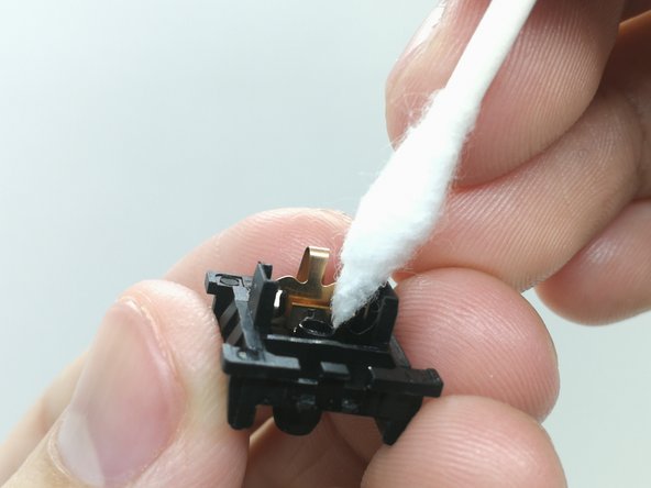

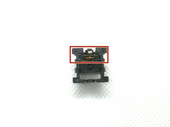

    • The four parts of a switch are the stem, top housing, spring, and bottom housing. Make sure you have all four parts before proceeding.
    • Check the metal leaf inside the bottom housing to make sure there is no rust or bends.
    • You may find some lubricant clinging onto the leaf, which can be wiped off using a cotton swab.

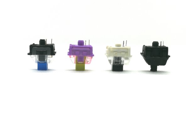

    • If you are replacing the switches that the keyboard comes with for aftermarket switches, be aware that not all aftermarket switches will fit into this keyboard. Since this keyboard uses Outemu hot-swap sockets, it will only accept switches with smaller pins.
    • In the photos, the switches on the left are compatible with this keyboard, while the switches on the right are not compatible with the keyboard due to their slightly thicker pins.
