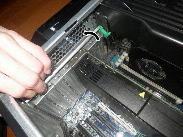

    • First, pull the handle and raise the upper part of the case.
    • Make sure that you have unlocked the lock that is located close to the handle.
    • After taking the upper part off, you'll see the covers of the different pieces of the PC.

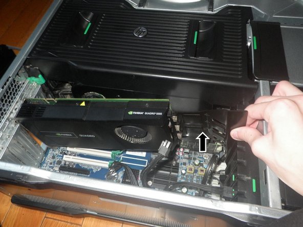

  2. Replace HP Z820 GPU., Opening the GPU compartment: шаг 2, изображение 1 из 3 Replace HP Z820 GPU., Opening the GPU compartment: шаг 2, изображение 2 из 3 Replace HP Z820 GPU., Opening the GPU compartment: шаг 2, изображение 3 из 3
    • Raise the cover of the left lower side.

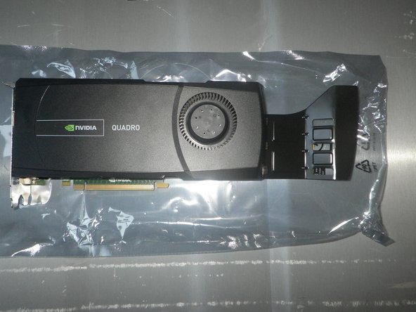

  3. Replace HP Z820 GPU., GPU with guide: шаг 3, изображение 1 из 1
    • This PC has a full-sized GPU with a guide that fits the GPU in the case. That allows you to avoid physicall damages on the GPU.
    • The GPU has a guide. It's necessary to pay attention and don't forget about it while taking the GPU off.

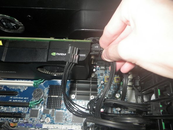

  4. Replace HP Z820 GPU., GPU Removal, Part 1: шаг 4, изображение 1 из 2 Replace HP Z820 GPU., GPU Removal, Part 1: шаг 4, изображение 2 из 2

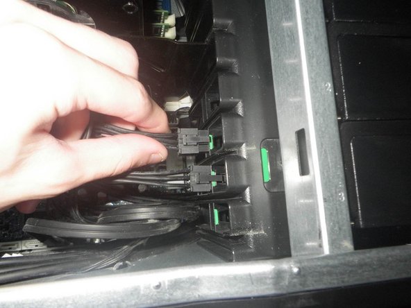

    • Disconnect the power connector from the GPU.
    • You can clip the connectors in a specifically designed place.
    • Raise the rod that maintains the PCI GPU in place.

  8. Replace HP Z820 GPU., Case's particularity: шаг 8, изображение 1 из 2 Replace HP Z820 GPU., Case's particularity: шаг 8, изображение 2 из 2
    • The Sapphire RX 5700XT GPU is the largest card that fits in the case without problems.
    • Maximum GPU height: 11cm.
    • As it's already explained, the case has special spots for clipping the unused power supply ports.
