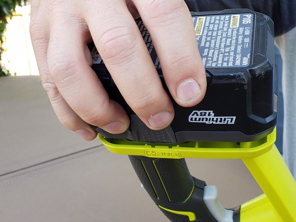

    • Press the button and pull to remove the battery.
