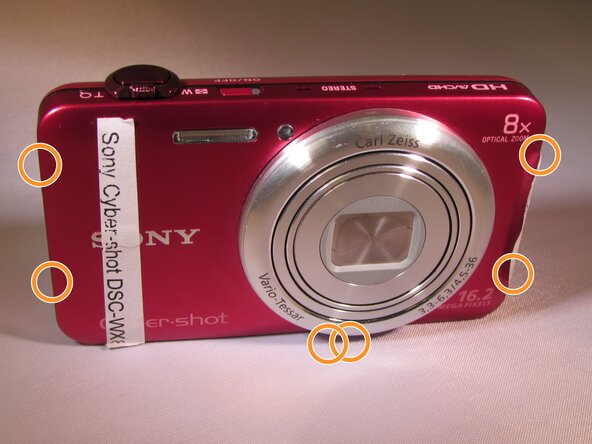

    1. Sony Cyber-shot DSC-WX80 Front Cover Replacement, Front Cover: шаг 1, изображение 1 из 3 Sony Cyber-shot DSC-WX80 Front Cover Replacement, Front Cover: шаг 1, изображение 2 из 3 Sony Cyber-shot DSC-WX80 Front Cover Replacement, Front Cover: шаг 1, изображение 3 из 3
      • Begin by removing all six screws holding the outer chassis together with the Phillips #00 screwdriver.
      • Remember to keep track of all screws as they are small and very easy to lose
