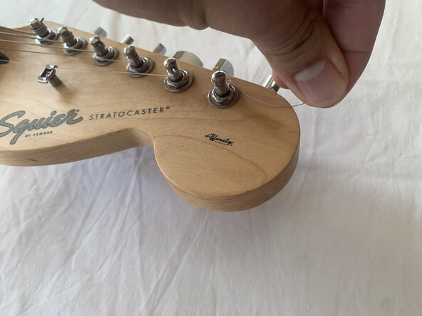

    • Loosen the string for the tuner you are replacing until there is a lot of slack in the string.
    • This should take roughly 10-20 counter-clockwise rotations.

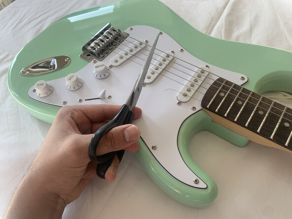

    • Use wire cutters or sturdy scissors to cut the string around the midpoint, being mindful of your eyes.
    • For thinner strings scissors will work, however for thicker strings wire cutters should be used.
    • Be careful when cutting the string. If there is too much tension, there is a possibility the string can snap back and can potentially hit you or those around you in the eye. To avoid this, make sure there is a great amount of slack in the string such that after being cut it will be limp.

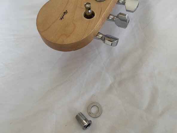

  3. Squier Strat Guitar Tuner Replacement: шаг 3, изображение 1 из 3 Squier Strat Guitar Tuner Replacement: шаг 3, изображение 2 из 3 Squier Strat Guitar Tuner Replacement: шаг 3, изображение 3 из 3

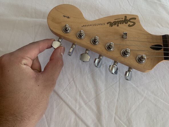

    • Unwind the string from the tower of the tuner.

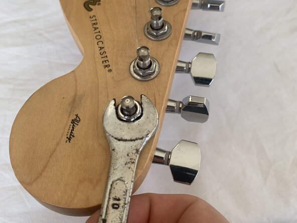

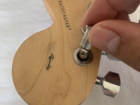

  4. Squier Strat Guitar Tuner Replacement: шаг 4, изображение 1 из 3 Squier Strat Guitar Tuner Replacement: шаг 4, изображение 2 из 3 Squier Strat Guitar Tuner Replacement: шаг 4, изображение 3 из 3

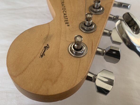

    • Use a 10 mm hex-wrench to remove the nut of the tuning tower.
    • Remove the tower, washer, and hex nut.

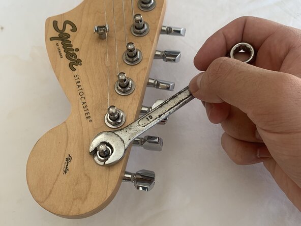

  5. Squier Strat Guitar Tuner Replacement: шаг 5, изображение 1 из 3 Squier Strat Guitar Tuner Replacement: шаг 5, изображение 2 из 3 Squier Strat Guitar Tuner Replacement: шаг 5, изображение 3 из 3

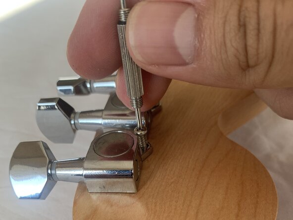

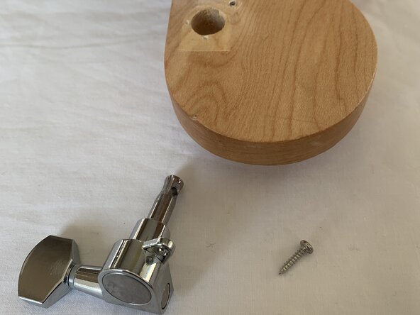

    • Using a small (1-2mm tip) Phillips screwdriver, remove the screw securing the tuner to the guitar's headstock.
    • Remove the tuner from the headstock and set it aside.
    • You may want to keep the tuner parts and screw if you wish to reuse the tuner in another guitar, or to save it as a potential backup!

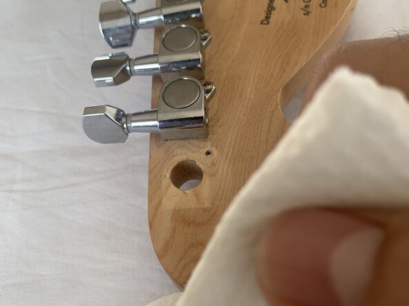

  6. Squier Strat Guitar Tuner Replacement: шаг 6, изображение 1 из 2 Squier Strat Guitar Tuner Replacement: шаг 6, изображение 2 из 2
    • Using a wet paper towel, or similar material, wipe down the surface where the replacement tuner will be.
    • This step is optional, although ensuring the surface is clean of dust and debris will ensure the tuner remains fixed.

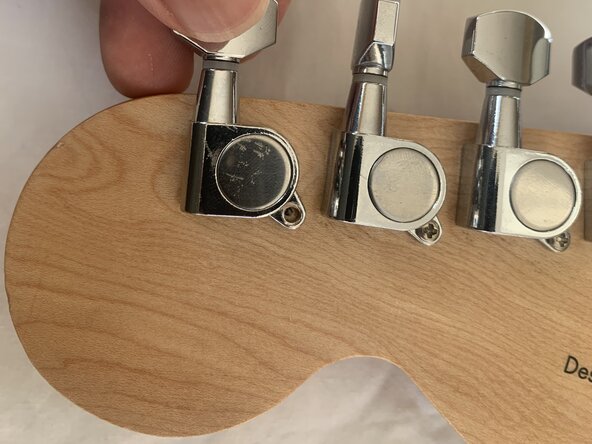

  7. Squier Strat Guitar Tuner Replacement: шаг 7, изображение 1 из 3 Squier Strat Guitar Tuner Replacement: шаг 7, изображение 2 из 3 Squier Strat Guitar Tuner Replacement: шаг 7, изображение 3 из 3
    • Insert the replacement tuners body into the tuner-hole.
    • Ensure the screw hole lines up with the screw-hole on the headstock.
    • Use the small Phillips head screwdriver to tighten the screw until the tuner is secure.
