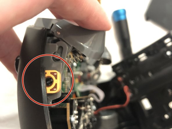

  4. SteelSeries Stratus XL Trigger Cleaning: шаг 4, изображение 1 из 2 SteelSeries Stratus XL Trigger Cleaning: шаг 4, изображение 2 из 2
    • Locate the trigger arm pot depending on which side you are having issues with on your controller.
    • Depending on what issues you may be having with your controller, the screw in the arm pot may appear different. Push the trigger down a couple times and see what happens to the screw.
    • If your controller is registering phantom clicks without you pushing it, the screw may be a little too tight. Turning the screw slightly to the left may solve this issue.
    • If your controller is not registering when you push the trigger, the screw may be a little loose. Turning the screw slightly to the right may solve this issue.
  5. SteelSeries Stratus XL Trigger Cleaning: шаг 5, изображение 1 из 1
    • Make minor adjustments to the screw inside the arm pot using your flathead screwdriver.
  6. SteelSeries Stratus XL Trigger Cleaning: шаг 6, изображение 1 из 1
    • Dip your Q-tip in a bit of isopropyl alcohol and dab a little bit into the arm pot. Be careful not to let any leak over any other parts of the controller.

Can't believe this actually worked! The quality of construction is dispicably poor, the cable had melted onto the trigger springs or something, I've never seen such shoddy construction in my life. I picked out the red plastic gunk and turned the screw as advised. It was a little lower in the frame in my case so hard to reach with the flathead, but with a little perseverance I managed to twist it anti-clockwise and I no longer get phantom presses on my trigger. Many thanks!
