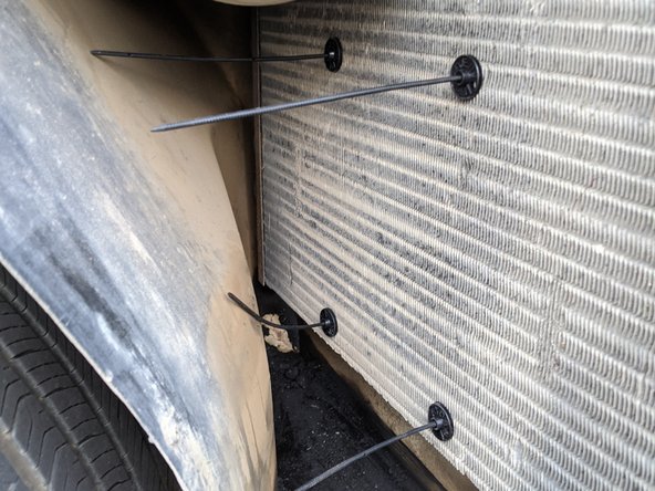

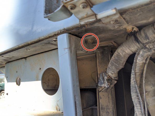

    • On my Vixen there was a hex head bolt on the top right, and a on-its-way-to-being-stripped Phillips head bolt on the top left.
  4. Vixen 21 Oil Cooler Replacement: шаг 4, изображение 1 из 1
    • There were two Phillips screws in the bottom of the panel, but these weren't actually attached to anything.
    • My new side-routed exhaust definitely made it harder to get this panel out.

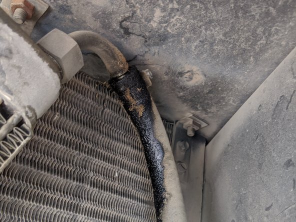

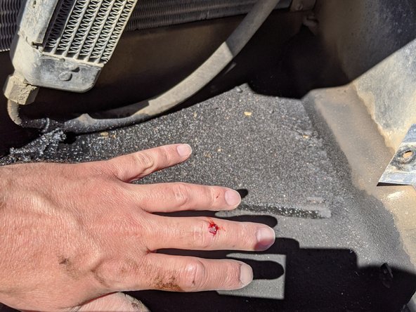

    • Once the condenser fan is removed we can get a good look at the oil cooler. The fittings are certainly leaking, but the cooler itself might actually be fine.
    • The Vixen bleeds black and I bleed red, whoops!

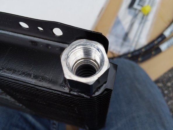

    • Here's all the shiny new replacement parts. You can buy the oil cooler kit from AFAB.
    • I made a mess of the threads putting one of the blue aluminum fittings in to the top of the new oil cooler. Thanks to a 1/2" NPT tap and die from Harbor Freight and a friend's help I was able to salvage it and I don't think it leaks, but time will tell...

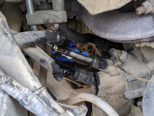

    • On a closer inspection, all my existing fittings are leaking, which at this point I suppose is a good sign.

    • It was easy enough to loosen the hose clamps and pop the hoses off.
    • This made a mess, because not surprisingly, there's oil in the lines.

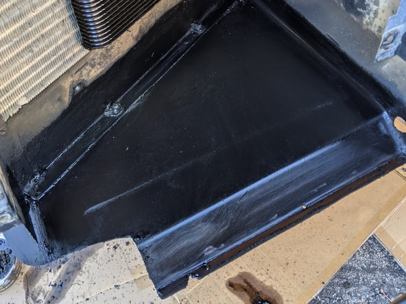

    • There was a lot of oil/dust sludge beneath the oil cooler, requiring a rather dirty cleanup.

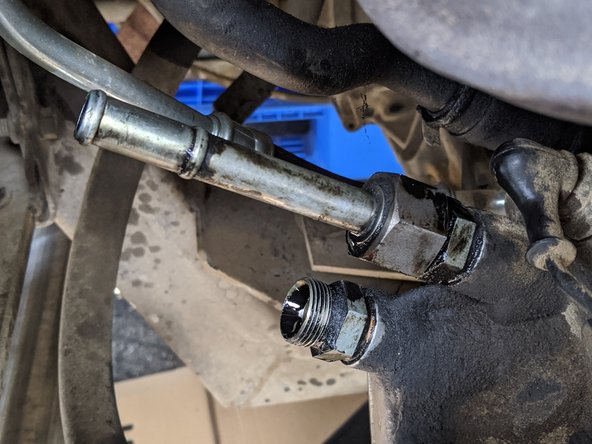

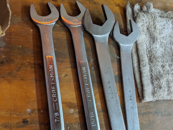

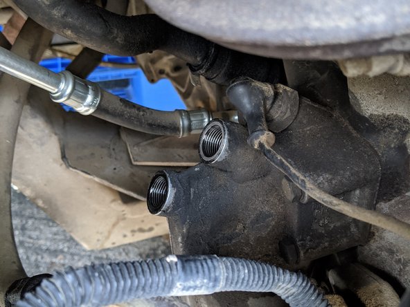

    • Removing the remaining couplers was quite challenging.
    • I was able to borrow some large metric wrenches (24 mm and 27 mm) from a friend to help with this step.
  14. Vixen 21 Oil Cooler Replacement: шаг 14, изображение 1 из 3 Vixen 21 Oil Cooler Replacement: шаг 14, изображение 2 из 3 Vixen 21 Oil Cooler Replacement: шаг 14, изображение 3 из 3
    • After the first fitting was off, I was able to get a 24 mm socket over the second one to remove the fitting.

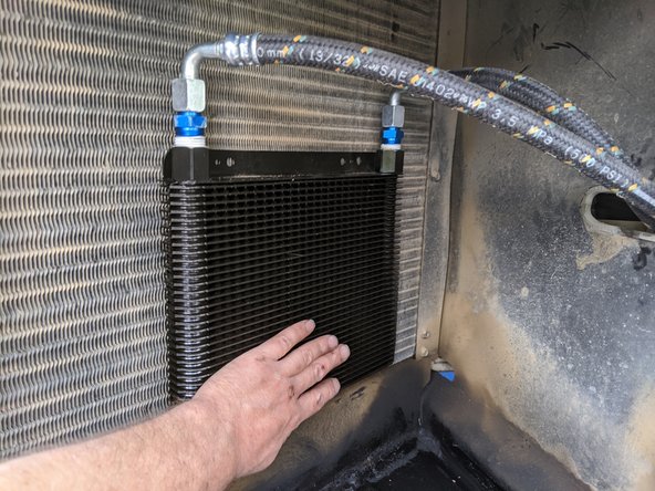

    • Mounting to the condenser is straightforward.
  18. Vixen 21 Oil Cooler Replacement: шаг 18, изображение 1 из 2 Vixen 21 Oil Cooler Replacement: шаг 18, изображение 2 из 2
    • Everything's in place!
    • I spent some more time cleaning the dirty panel below. Thus far I have no leaks from the new oil cooler!
