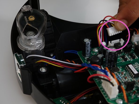

    • Remove three circuit plugs from the motherboard. Pinch the small white tab on the side of each circuit plug and pull straight up to release each from the motherboard.
    • 1. On the bottom left corner: a small connector with red, black and white wires.
    • 2. One thick white wire that attaches on the right side of the previous connector.
    • 3. On the top edge of bOb’s motherboard: a wide multicoloured connector.

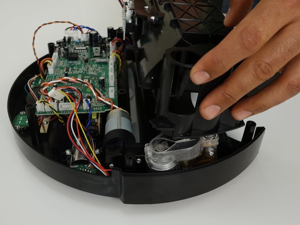

    • When all screws and circuitry are disconnected, lift the wheel cover up and put aside for later.

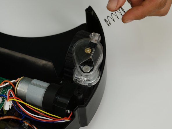

    • You will see bObsweep's left and right wheels exposed.

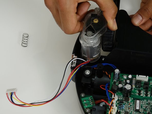

    • There is a spring sitting atop each wheel. Remove the spring from the wheel you wish to replace, and put aside for later.

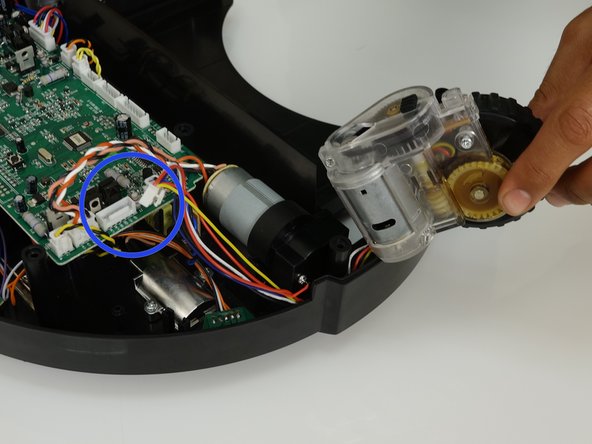

  8. bObsweep Robotic Vacuum Cleaner Left or Right Wheel Replacement: шаг 8, изображение 1 из 3 bObsweep Robotic Vacuum Cleaner Left or Right Wheel Replacement: шаг 8, изображение 2 из 3 bObsweep Robotic Vacuum Cleaner Left or Right Wheel Replacement: шаг 8, изображение 3 из 3
    • Lift the appropriate wheel up and you will see where it plugs in to the motherboard.
    • The multicolored wires for bOb's right wheel connect in the centre of the motherboard's left edge.
    • But the circuit plug for the left wheel connects to the bottom edge of the motherboard, closer to its right side.
  9. bObsweep Robotic Vacuum Cleaner Left or Right Wheel Replacement: шаг 9, изображение 1 из 3 bObsweep Robotic Vacuum Cleaner Left or Right Wheel Replacement: шаг 9, изображение 2 из 3 bObsweep Robotic Vacuum Cleaner Left or Right Wheel Replacement: шаг 9, изображение 3 из 3

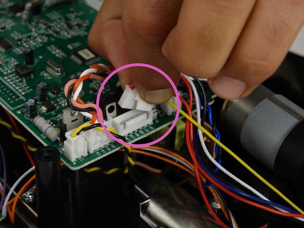

    • Pinch the white tab on the side of the correct circuit plug to release it from the motherboard, and pull up to disconnect completely.
    • The old left or right wheel will be fully detached from bObsweep.
  10. bObsweep Robotic Vacuum Cleaner Left or Right Wheel Replacement: шаг 10, изображение 1 из 2 bObsweep Robotic Vacuum Cleaner Left or Right Wheel Replacement: шаг 10, изображение 2 из 2

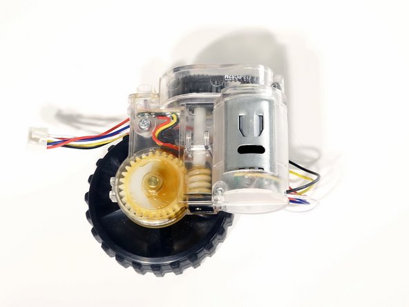

    • Once the old wheel is removed, place the new one in its place.
    • The motor should be closer to the outside while the wheel sits closer to the interior.
