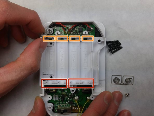

  4. iDevices iGrill Probe Replacement: шаг 4, изображение 1 из 3 iDevices iGrill Probe Replacement: шаг 4, изображение 2 из 3 iDevices iGrill Probe Replacement: шаг 4, изображение 3 из 3
    • If you have not removed the 2 silver-colored screws; you must remove them now.
    • Remove the metal terminals from the battery slot closest you.
    • Pull the remaining metal terminals out of their slots. Position them such that when removing the internal cover they will not be caught.
    • Remove the internal cover.
