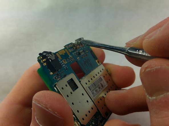

  7. Blu Dash 5.0 Dual SIM Charging Port Replacement, Charging Port: шаг 7, изображение 1 из 1
    • Solder the pins on the back of the charging port. Here's a guide to soldering: How to solder
    • Soldering iron can be very hot!
  8. Blu Dash 5.0 Dual SIM Charging Port Replacement: шаг 8, изображение 1 из 2 Blu Dash 5.0 Dual SIM Charging Port Replacement: шаг 8, изображение 2 из 2
    • Pry charging port away from the board using the metal spudger.
    • It's easier to pry with the metal spudger inserted in the charging port.
