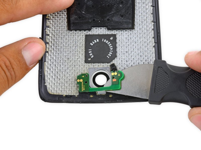

    1. Motorola Droid Turbo Dual LED Flash Board Replacement, Dual LED Flash Board: шаг 3, изображение 1 из 2 Motorola Droid Turbo Dual LED Flash Board Replacement, Dual LED Flash Board: шаг 3, изображение 2 из 2
      • Use a Jimmy to separate the dual LED flash board from the rear case.
      • The board is secured with some light adhesive, so some force may be required.
