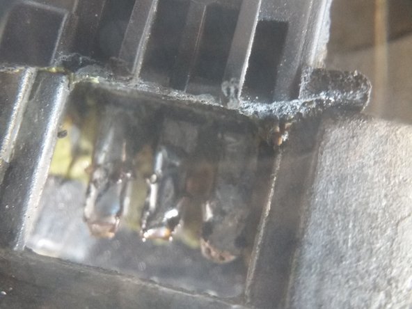

    • Dig the silicone sealer out of the right side to expose the position sensor wire terminals. The terminals are spot welded (yes, WELDED) together to the leads from the computer module. Use small sharp diagonal cutters to separate the terminal leads.

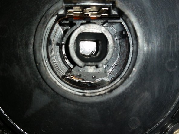

    • The inside of the housing and the position sensor will both have an oily mess. Clean them by spraying with carb spray or contact cleaner.
  4. Volvo Throttle Body fix: шаг 4, изображение 1 из 2 Volvo Throttle Body fix: шаг 4, изображение 2 из 2
    • Carefully pry out the metal ring that protects the sliding contacts. You can clean them with some spray cleaner.
  5. Volvo Throttle Body fix: шаг 5, изображение 1 из 1
    • Reassemble the metal ring. Apply silicone adhesive around the outside edge, then reinstall the sensor into the throttle body.

    • Wrap some wire strands around the terminal ends to help hold them together tightly. Solder the terminals together (but NOT to each other!).
