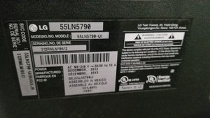

I have a LG universal remote. All buttons work appropriately with my LG55 TV except for the home button. When I push it, it takes you to settings instead. I have to use another remote to get to the home screen on my lg tv. I cannot find any help on the Internet to tell me how to reprogram the HOME button to go to the HOME screen. Any suggestions?

Hi @retiredfinally ,
Has it ever worked properly?
According to this link your model TV is not in the list of TVs that are compatible with the remote. (Scroll down the list of remote model numbers and find AKB72915239 to view the list of compatible LG TVs).
If it has never fully functioned correctly, perhaps this is why.
According to this link the compatible LG universal remote for your model TV is a LG AN-MR400. (Scroll down to find your TV model (LN5790) in the list of compatible TVs
Hopefully this is of some help.
Update (04/08/2018)
If you have no need for a universal remote, (because you don't wish to operate other devices as well as the TV using the same remote), then I suggest that you consider this option as it is a lot cheaper than the universal remote.
Not sure why the AN -MR400G that you have doesn't work but since they don't return for a refund if possible.
If you do want a universal remote then perhaps you should order from the link I provided, as it is LG shop so if it doesn't work you can ask them why because they state that your model is compatible.
