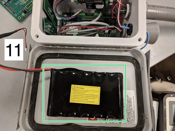

      • 10. Using velcro, re-secure the relay board to the side of the enclosure.
      • 11. Using velcro, attach the lithium ion battery to the inside of the enclosure door.
      • Be sure to clean the surfaces beforehand.
      • Be sure the soft side is attached to the enclosure.

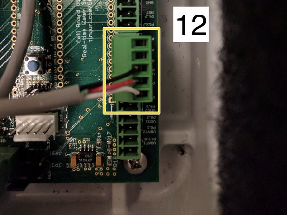

      • 12. In case the wiring of an ultrasonic sensor comes loose, here is the wiring.

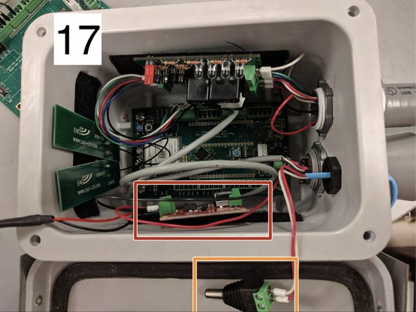

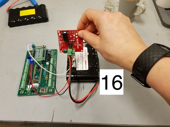

      • 15. Reconnect the grey autosampler connector from the autosampler to the node.
      • 16. Reconnect lithium ion battery in the node.
      • 17. Plug in the solar panel into the solar charger last.
