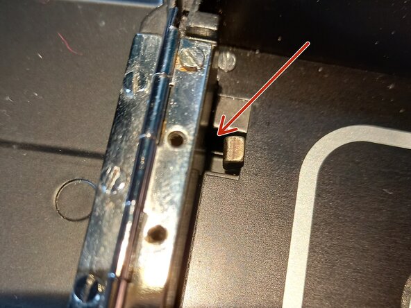

    1. Disassembling Konica Compact 8 Filmdoor, The latch door: шаг 1, изображение 1 из 1
      • These 4 screws are all that holds the latchdoor connected to the body.
      • It also holds the metal that will keep the film cartridge in place. This is a seperate piece that lays underneath the latch.
