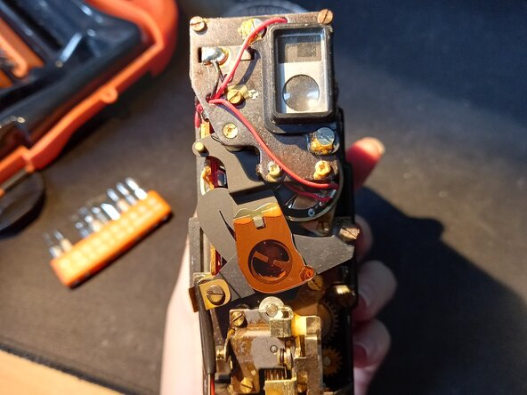

    4. Disassembling Konica Compact 8 Front Cover, Finish: шаг 4, изображение 1 из 1
      • The machinery is now open and can be dissasembled further or the front cover might be cleaned freely without worry that cleaning liquid would seep into the camera.
      • Make sure to remember what the "roll and lock" switch was on before dissassembly or to not touch it at all.

    5. Disassembling Konica Compact 8 Front Cover, Optional: Pushing lever back in place when reassembling: шаг 5, изображение 1 из 1
      • You might need to push the brass lever that holds the wires in place (right under the small board on the leftside) up to fit the front cover back on.
      • If its stuck in place in the wrong position, loosen the screw attached to it a little bit to pry it back in it's original position.

To reassemble your device, follow these instructions in reverse order. You might need to push the brass lever that holds the wires in place (right under the small board on the leftside) up to fit the front cover back on. Mine had shifted downwards after taking the cover off and the topcover did not fit back because of it. If its stuck in place in the wrong position, loosen the screw attached to it a little bit to pry it back in it's original position.
