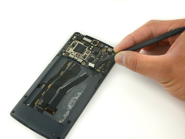

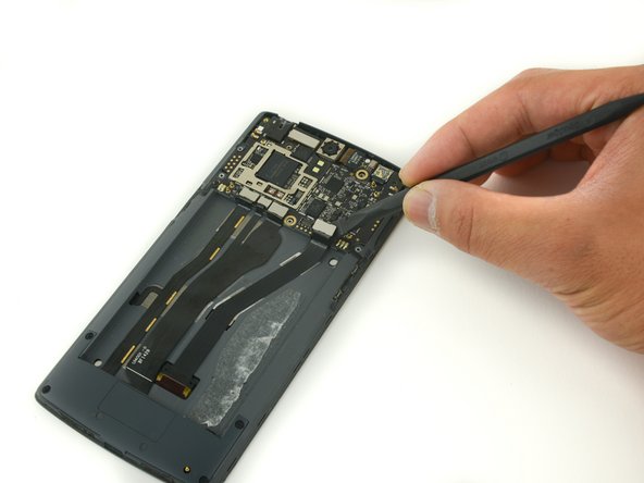

    • Using a black spudger, disconnect all connectors by lifting up gently.

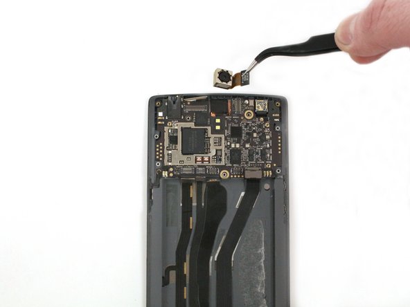

    • Using a pair of tweezers, gently lift the front facing camera out of the device.

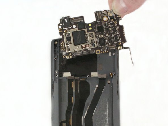

    • Gently lift the top side of the motherboard and disconnect the antenna to free it from the device.
    • The volume and power buttons are soldered onto the motherboard and must be removed with it. To make the process easier, gently pry the buttons out before removing the motherboard.
