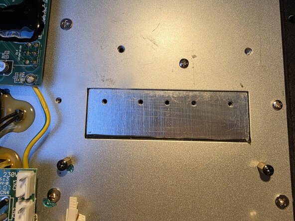

    1. REL T5 Clean backplate, Remove thermal paste: шаг 1, изображение 1 из 2 REL T5 Clean backplate, Remove thermal paste: шаг 1, изображение 2 из 2
      • Carefully remove silica pads, take note: they are very fragile!
      • Remove excessive black putty where needed.
      • Thoroughly clean back plate with Isopropyl Alcohol (IPA).
      • Clean silica pads as well and store them.
