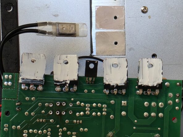

    1. REL T5 Repaste transistors, Repaste heatsink and pads: шаг 1, изображение 1 из 3 REL T5 Repaste transistors, Repaste heatsink and pads: шаг 1, изображение 2 из 3 REL T5 Repaste transistors, Repaste heatsink and pads: шаг 1, изображение 3 из 3
      • Re-apply thermal grease. Make sure to use an appropriate type. Hint: CPU paste is usually not the best solution.
      • Apply a little dot on the pad and place on the heatsink.
      • After speading it with a spatula, stick two together, and slide to distribute evenly.
      • Careful as to not damage the pads!

    2. REL T5 Repaste transistors: шаг 2, изображение 1 из 1
      • Apply a thin layer using the spatula on the transistors as well.
      • Mount the amplifier board back on its place.
      • Carefully set the transistors using the screws.
      • Fix the power board using its screws.
      • Check that there are no shorts between the transistors and the heatsink or backplate.
