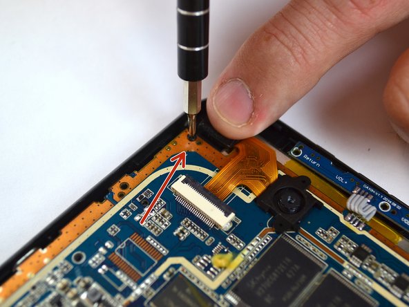

    4. Tagital T10 Power button Replacement: шаг 4, изображение 1 из 2 Tagital T10 Power button Replacement: шаг 4, изображение 2 из 2
      • Remove all of the 4mm screws that attach the motherboard to the rest of the device.
      • One screw is located beneath the black tape that holds the rear-facing camera in place. Peel the tape up to access it.
      • There should be a total of 7 screws at size PH000.

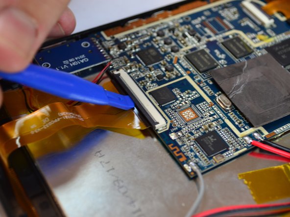

    5. Tagital T10 Power button Replacement: шаг 5, изображение 1 из 2 Tagital T10 Power button Replacement: шаг 5, изображение 2 из 2
      • Locate the 2 ZIF connectors.
      • Flip up the black tab to release the two filaments, so that they are no longer connected to the motherboard.
